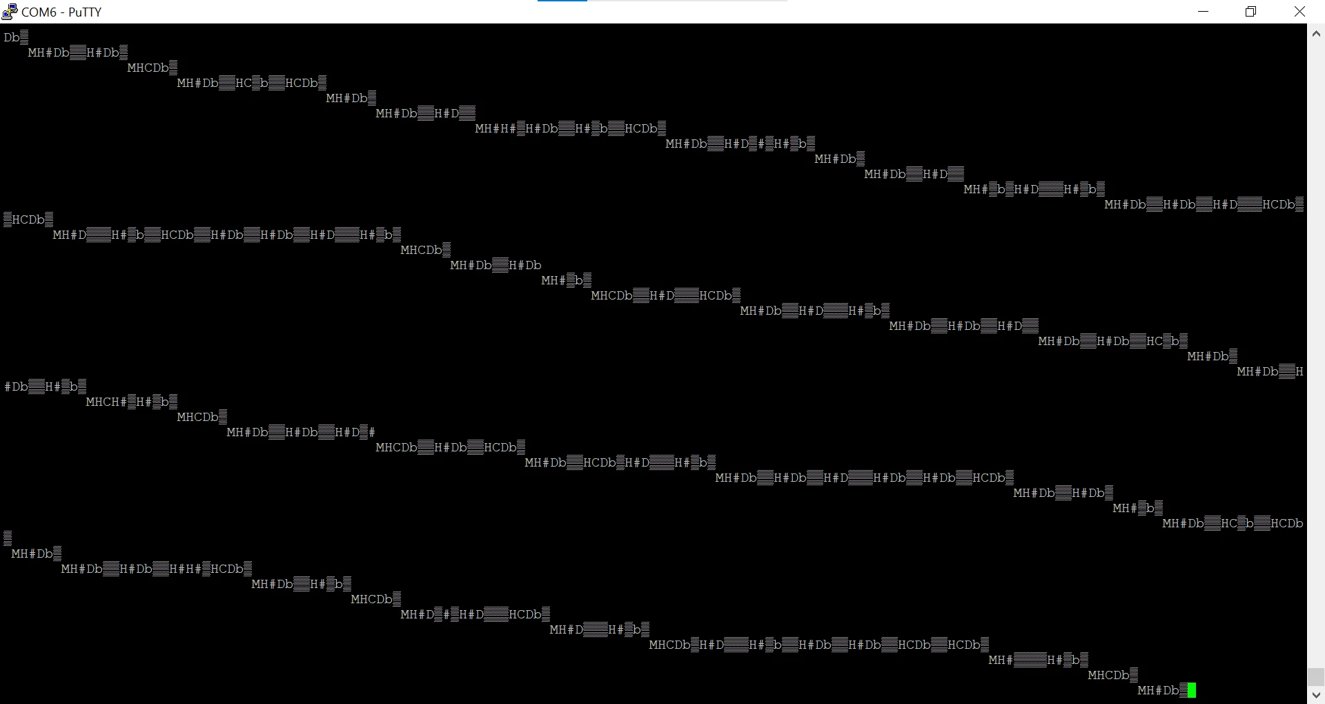

Hello everyone. I'm having a problem with serial data transmission.
  • February 1, 2023
  • 12 replies
  • 5522 views
I'm using a STM32L152C-Discovery and a USB-RS232 adapter to receive data via UART protocol from the board. The system clock is 32 MHz and I'm using a baud rate of 115200 and no parity check. To view the messages on the PC, I use Putty configured consistently with the transmission parameters. When I try to send data via HAL_UART_Transmit the serial monitor shows completely different data. In the case of repeted "Hello world" message I get the following result:
I also thought about low precision clock problems, if this were the case, how can I verify the correctness with the oscilloscope?

The converter on the photo above uses RS232 levels. You need to use USB-UART "TTL" type converter with 3.3 Volt output, not USB to RS232.
My STM32 stuff on github - compact USB device stack and more: https://github.com/gbm-ii/gbmUSBdevice
Tesla DeLorean
Guru
February 1, 2023
RS232 has different levels, and inverts, so data will often look as shown, ie patterns consistent, size/form, but wrong characters.
