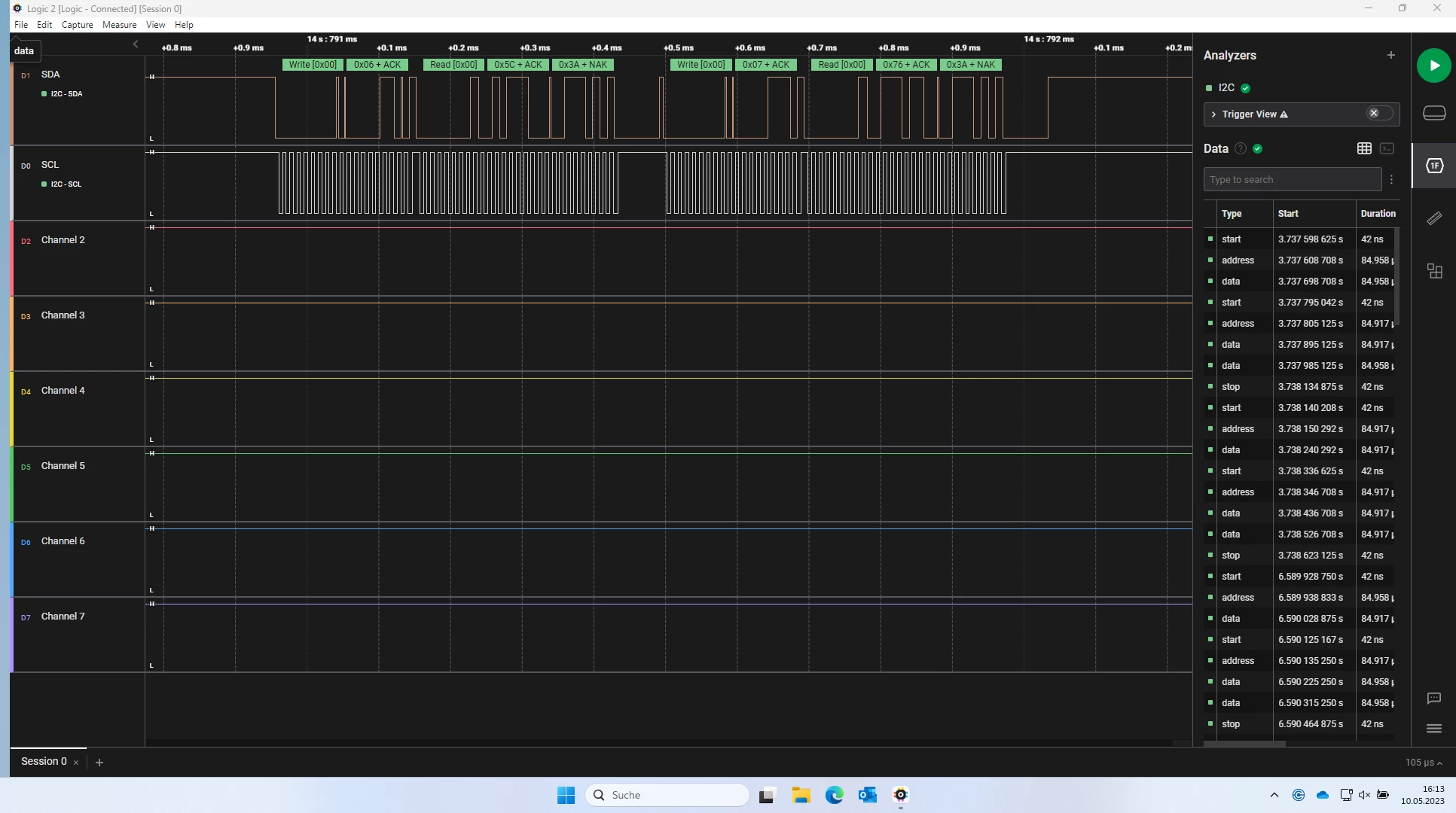

Hello Everyone, I am trying to interface MLX90614 sensor I2C with stm32F401 Discovery board and i have configured stm32 cube MX in standard mode. My sensor works fine and I am using logic analyser to analyse my SCL and SDA signals.
However, I am getting 0x3A(NACK) in stop condition of my logic analyser. Can anyone help me how i can convert this NACK to ACK. I am attaching my code snippet and my logic analyser signal as well . Thanks for help and support.

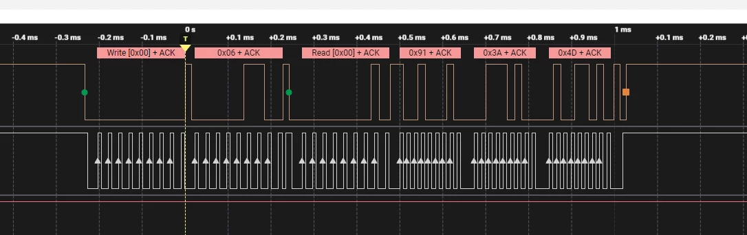

i have simulated this project using SMBUS and I got this siganls.
I want to achieve the same signals.
Can you please help. How i can get the same signals in I2C.

Hello Foued
Thanks for your reply. Sorry I misinterpret your answer. Actually 0x3A is error code.
Can you please look at my code and please tell me what i need to modify to get ACK

Why did you create a duplicate topic? It is forbidden! And why the code is not in a Code Snippet?
Read the I2C specification and you will understand why there is a NACK on the last byte.
