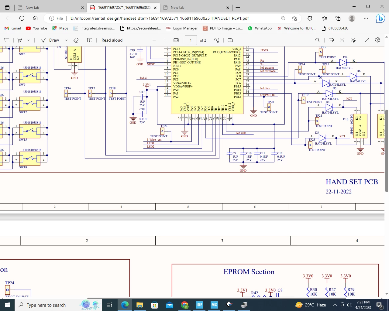

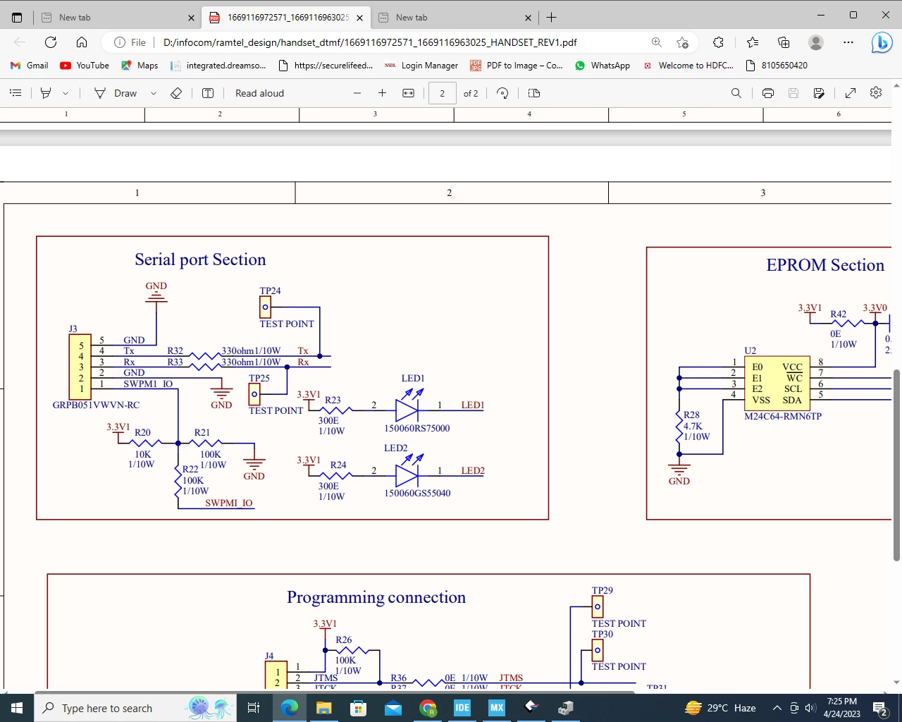

I developed Hw design and and now writing firmware for stm32L476 microcontroller. Requirement of project is Single wire communication. I chose STM32L476, the reason behind was single wire communication (SWMPI on Port B pin12) peripheral present in this microcontroller. I took Bit rate 100kBits/sec.I connected both boards using swmpi wire and ground pins. Problem is that single wire communication is not working. I am not able to receive data at receiver side board.

Please help in this regards . I have also attached hardware schematic snap shots

Define "not working"
Perhaps use a scope or logic analyzer to review signals and contrast against expected signals.
Your UART transmit doesn't seem to output enough data

I am sending data one WORD size. with value 0x12345678 from one board as Transmitter unit ;
And Other MCU board Unit as Receiver to read data from SWMPI single wire communication.
But I got value as 0x00 00 00 00 , as four bytes. I also used Oscilloscope to view data pattern.
