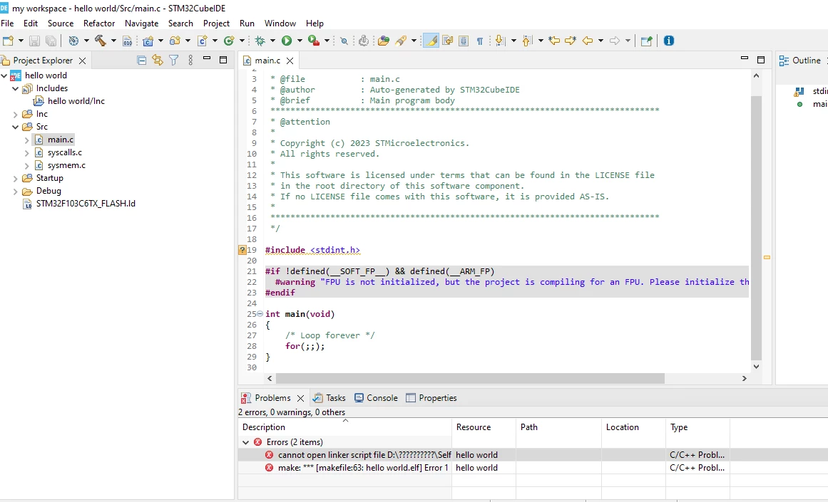

hello can any one help me ? Description Resource Path Location Type cannot open linker script file D:\??????????\Self Learning\???????????? ??????????\nti arm microcontroller\my workspace\hello world\STM32F103C6TX_FLASH.

Does the path to the linker have non-ascii characters in it?

how can i change the path of the linker ,please?

Doesn't look like a usable path.
Avoid Hieroglyphs and Pictograms, and use simple paths with Western characters.

You edit it in the project settings -> Tool settings -> Linker
