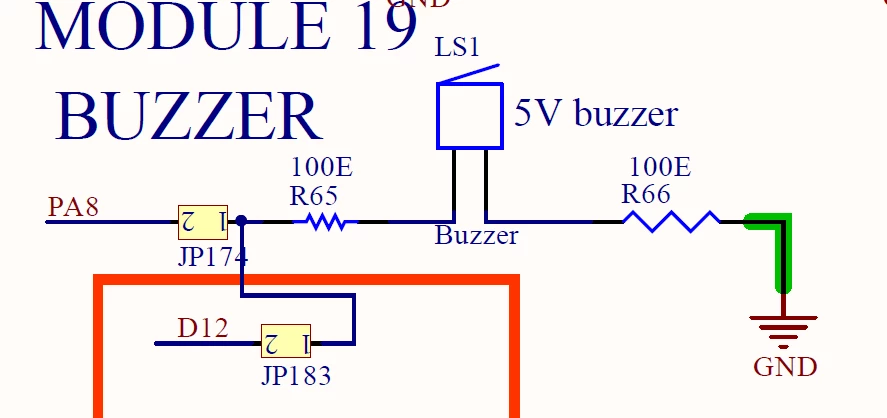

Hello All, I interfaced buzzer with my NucleoF103RB board, schematic and code attached with this post. now the problem is my buzzer is not playing loudly and I used one loop to increment the duty cycle, it is was not playing continuously.

    May 15, 2021 4:22 PM UTC
    > ...now the problem is my buzzer is not playing loudly...
    You're driving a 5V buzzer with a 3.3V signal. Also, you may be exceeding the current limit of the GPIO.
    >...and I used one loop to increment the duty cycle, it is was not playing continuously.
    > htim1.Init.Period = 99-1;
    > while (value<255)
    > htim1.Instance->CCR1 = value; // vary the duty cycle
    > value += 20; // increase the duty cycle by 20
    Once CCR1 >= 99 (and while CCR1=0), you are outputting a DC signal. Driving a buzzer with a DC signal produces no sound.

    What is the part# for the buzzer?
    I would expect the 3V and the resistors would tend to limit the loudness of a 5V buzzer.
    Is it a part which expects continuous power, or modulation?

    ok Thanks, then I will check the 5v pin first, I will try once then I will come back.
