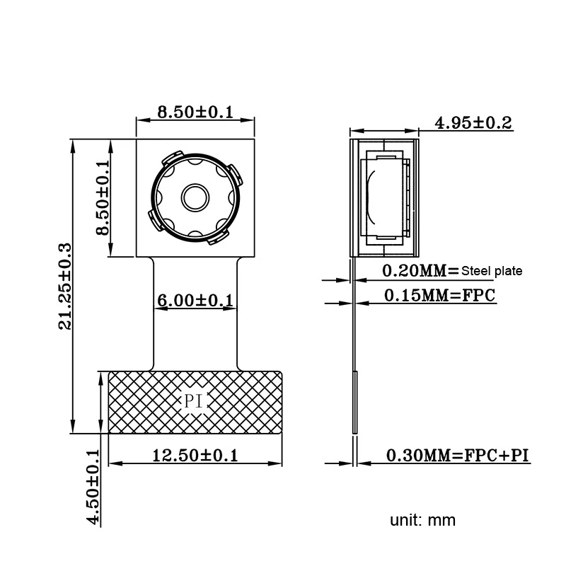

    lol i randomly found this online it says its the same part number but not quite sure
