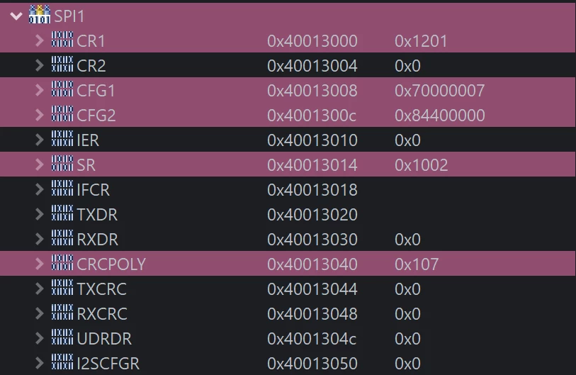

December 2, 2023
Try this. Works for me on H723 just now.
You might be getting a MODF error with your code, although your register printouts at the first post don't show it.
 SPI_TypeDef* SPIx = SPI1;

 If that doesn't work, show your registers with your latest code. Should be this at the end of the above sequence:
briankaz
briankazAuthor
December 2, 2023
Thanks!  Here are the results for the registers:
CR1 = 00001201
CR2 = 00000000
CFG1 = 70000007
CFG2 = 84400000
IER = 00000000
SR = 00009007
IFCR = 00000000
TXDR = 00000000
RXDR = 00000000
CRCPOLY = 00000107
TXCRC = 00000000
RXCRC = 00000000
UDRDR = 00000000
I2SCFGR = 00000000
 Looks like the same as what you got except for SR.  Here are the bits I have set that are cleared in your example:
1) RXWNE = 1
2) DXP = 1
3) RXP = 1
The SD card was present when I ran your code so it's possible that it had an affect on these results...
December 2, 2023
Looks like it's working then. My debugger is reading RXDR which is the difference in SR.
