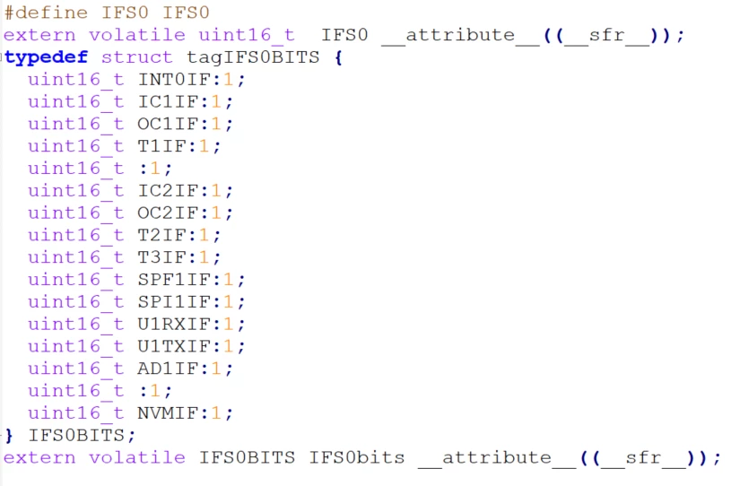

Having recently started with STM32 I am keen to get into programming in closer detail. Where can I find the "h" file defining the register list structure and the bit names as defined in the reference manual for the STM32F401RE ? see PIC24F32KA304 exa

I'm using a different chip, but that doesn't matter much.
When creating a plain new Blinky project in STM32CubeIDE, the following folder structure is generated:

Register definitions belong to the vendor+MCU specific part of ARM CMSIS: Drivers\CMSIS\Device\ST\STM32F0xx\Include\stm32f042x6.h
The path may be slightly different when using other IDEs or command line build tools.
The definitions look a bit different, because no bit fields are used. Lets take a LED connected to GPIO Port B pin 3 for example. At first, port GPIOB must be switched on (which is typical for ARM devices):
RCC->AHBENR = RCC->AHBENR | RCC_AHBENR_GPIOBEN;

Absolutely fantastic. Thank you so much for your answer and the detail you have gone to the explain the solution. I found my file as being STM32F401xE.h :)
Using the on-chip temperature sensor I couldn't understand why the compiler kept complaining about TSVREFE not being previously defined, now i know why as it is ADC_CCR_TSVREFE :)
