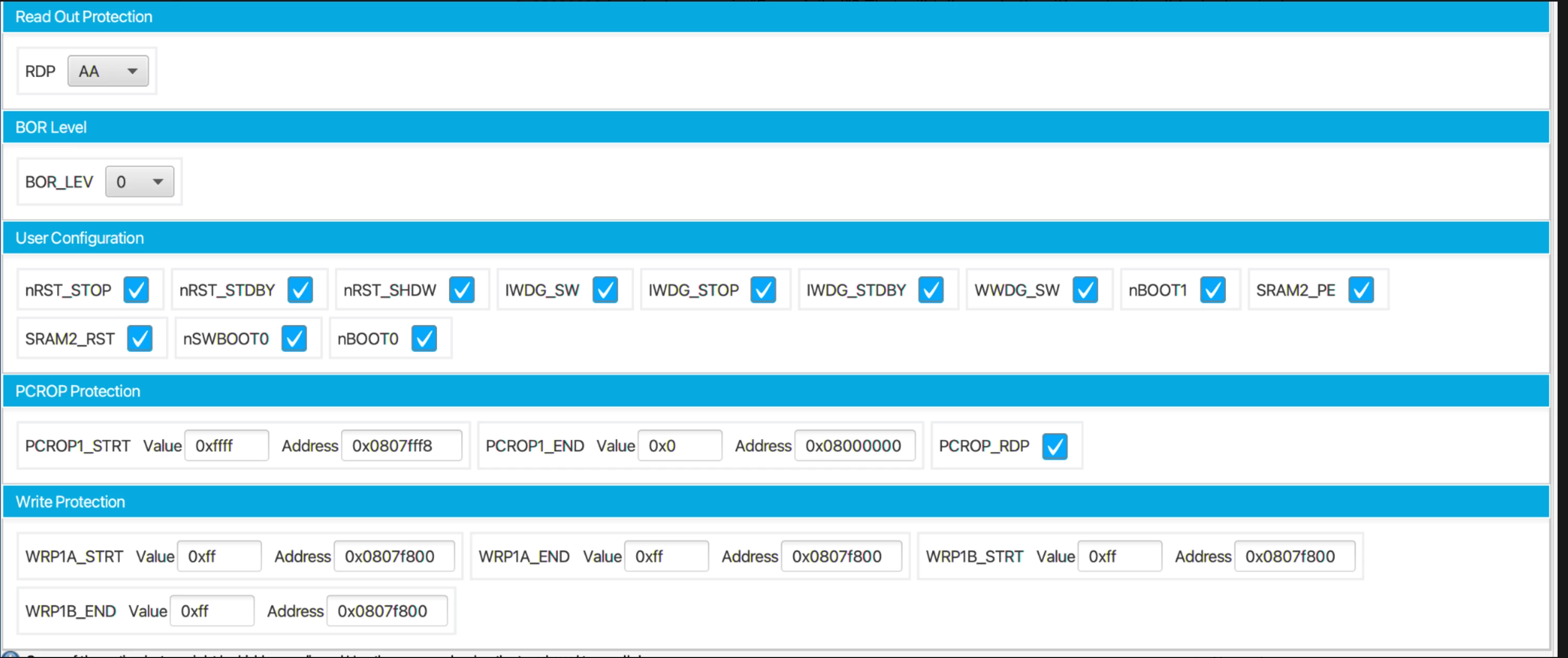

Has ChatGPT bricked my NUCLEO-L433RC-P board :(
I wanted to do a full chip erase using STM32Programmer (I am trying to debug a custom bootloader) but kept getting the error "Mass erase operation failed.  Please verify flash protection".
I sent the following option byte screenshot to ChatGPT....
ChatGPT said...
Problem: PCROP Protection
In your PCROP Protection section:
  • PCROP1_STRT = 0xFFFF
  • PCROP1_END = 0x0000
  • PCROP_RDP is enabled
This is an invalid PCROP range: start at 0xFFFF, end at 0x0.
That effectively protects a huge chunk of flash against erase/program.
So even though WRP and RDP are fine, PCROP is blocking your erase.
Fix
  1. In STM32CubeProgrammer → Option Bytes → PCROP:
    • Set PCROP1_STRT = 0xFF
    • Set PCROP1_END = 0xFF
    • Uncheck PCROP_RDP unless you specifically need PCROP linked to readout protection.
  2. Apply changes (Program Option Bytes → Reset).
  3. Retry Full Chip Erase with ST-Link.
I did the suggested fix but it obviously didnt work.
But worse still, I cant even change the option bytes back to as they were because I get the following error....
18:45:49 : UPLOADING OPTION BYTES DATA ...
18:45:49 : Bank : 0x00
18:45:49 : Address : 0x40022020
18:45:49 : Size : 20 Bytes
18:45:49 : OPTION BYTE PROGRAMMING VERIFICATION:
18:45:49 : Error: Expected value for Option Byte "PCROP1_END": 0x0, found: 0xFF
18:45:49 : Error: Expected value for Option Byte "PCROP1_STRT": 0xFFFF, found: 0xFF
18:45:49 : Error: Option Byte Programming failed Or modified by application after OB_LAUNCH
I cant program or debug in STMCubeIDE either so Im worried my board is bricked.
Is it recoverable and if so how ?

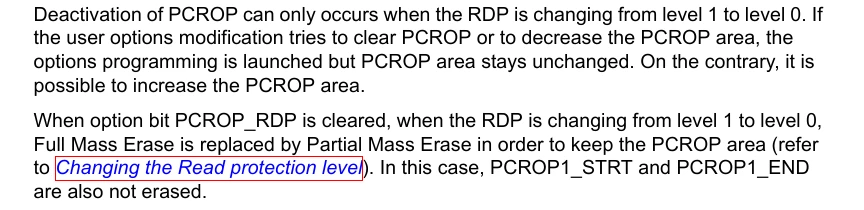

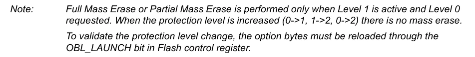

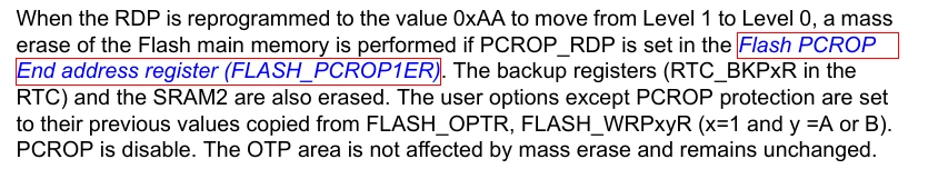

Before you give up - maybe last action:  to reset the pcrop...whatever its now....
So try set : Uncheck PCROP_RDP + set RDP to level1 (protected) , 01  (or whatever, but NOT 0xCC !);
then restart/ power cycle and set Uncheck PCROP_RDP + RDP to 0xAA , to do regression;
then apply....
restart/ power cycle....and we know.

click on the icon OB you might have write protection active
freeflyerAuthor
Senior II
Sep 22, 2025 2:16 PM UTC
Write protection is set to level 0 (0xAA) as shown in the OB in the screenshot in the original post
MNapi
Senior II
Sep 22, 2025 4:26 PM UTC
SPRMOD is enabled uncheck and click apply
