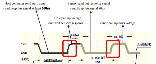

"I see that these sensors uses a Serial Interface (Single-Wire Two-Way) communication protocol"
Most of these "single-wire" protocols are proprietary - did you see any reason to believe that the specific protocol used by these sensors is compatible with the SWPMI on the H7 ?
@M abouhasem​ - Being proprietary, it is quite likely that any code you find on the interwebs will be bit-banging it, therefore that should be easy to port to any other microcontroller - the only bits specific to the particular microcontroller would be:
  1. How to pull a pin low;
  2. How to release a pin (Hi-Z);
  3. How to read the state of a pin;
  4. How to define the timing

If you already have a working platform, record the bus signals in both instances (F0/F4 vs. F7/H7), and compare them.

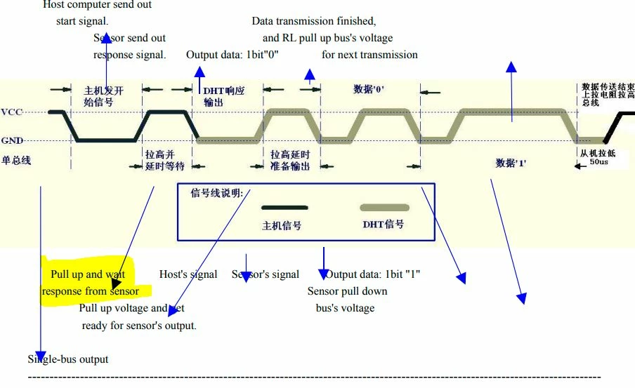

the same code worked fine with same sensor with both f4 and f0 MCUs as per datasheets its mandatory requirement to pullup and wait
Andrew Neil
Mar 2, 2021 1:02 PM UTC
"the same code worked fine with same sensor with both f4 and f0 MCUs"
So, again, compare what happens with your working code against what happens with your non-working code - that will show you where it's going wrong.
"its mandatory requirement to pullup"
Did you read my previous reply?
"Pullup" means that you let the pullup resistor do the pulling - you do not want the controller to actively drive high.
It's exactly the same principle as used for I2C: the drivers only ever pull down - it's the pullup resistors which do the pulling up.
That's why you see the rounded rising edges:
