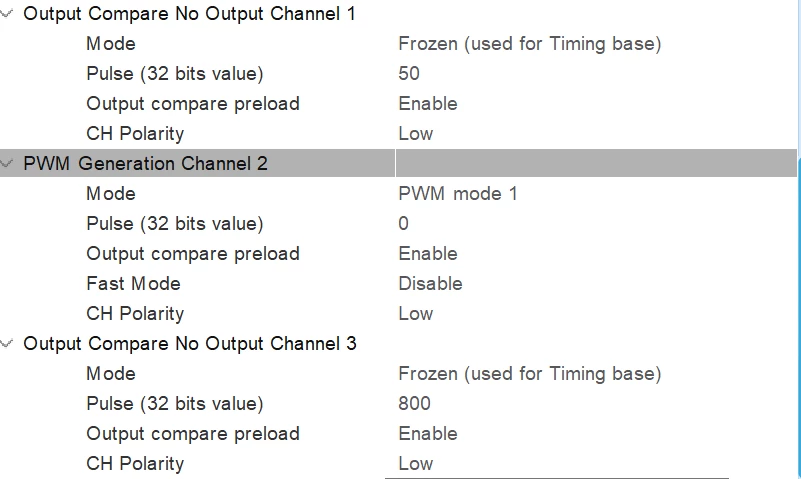

For every pwm pulse start at 50 usec I am setting the user_led and reseting the led1 and at 800 usec I am resetting the user_led and seting the led1.

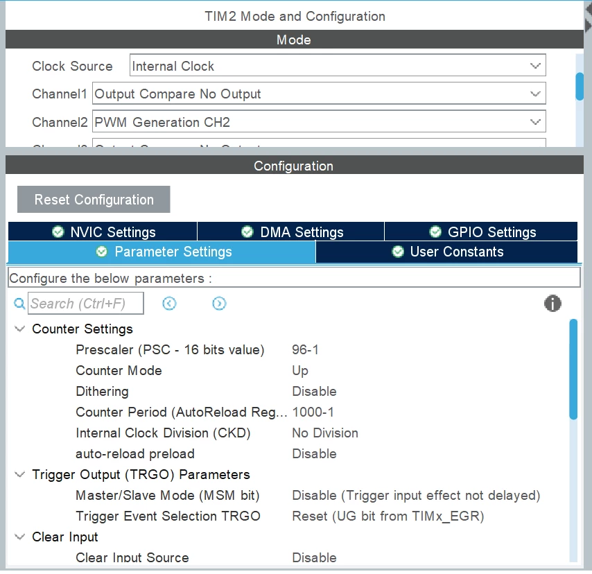

But with below code For every pwm pulse at 12 usec setting the user_led and reseting the led1 and at 24 usec (means after 10 usec of setting the user_led and reseting the led1) resetting the user_led and seting the led1 is happening.

For PWM I configured TImer2 with 1Khz.duty cycle I am setting through function.
For 50 usec channel1 I set pulse to 50 is it correct or not?same with channel3 for 800 usec.
