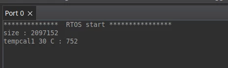

its a problem with the cache : disable cache, then see:
	 int flsz = FLASH_SIZE;
	 printf("size : %d \n", flsz);
	 int regval = *TEMPSENSOR_CAL1_ADDR;
	 printf("tempcal1 %ld C : %d \n", TEMPSENSOR_CAL1_TEMP, regval);
To be able to read into system flash you need to disable the cache associated to this area.
This can be done by setting non cacheable attribute this this region.
You have an example for accessing this UID in the STM32CubeH5 here:
STM32Cube_FW_H5_V1.3.0\Projects\NUCLEO-H563ZI\Examples_LL\UTILS\UTILS_ReadDeviceInfo\
(by Jocelyn R.)

Apr 26, 2025 11:16 AM UTC
Thank you so much!
