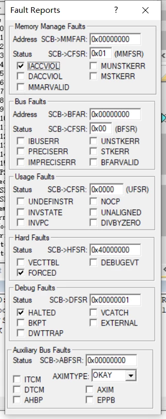

1. The fault reporter(debug):

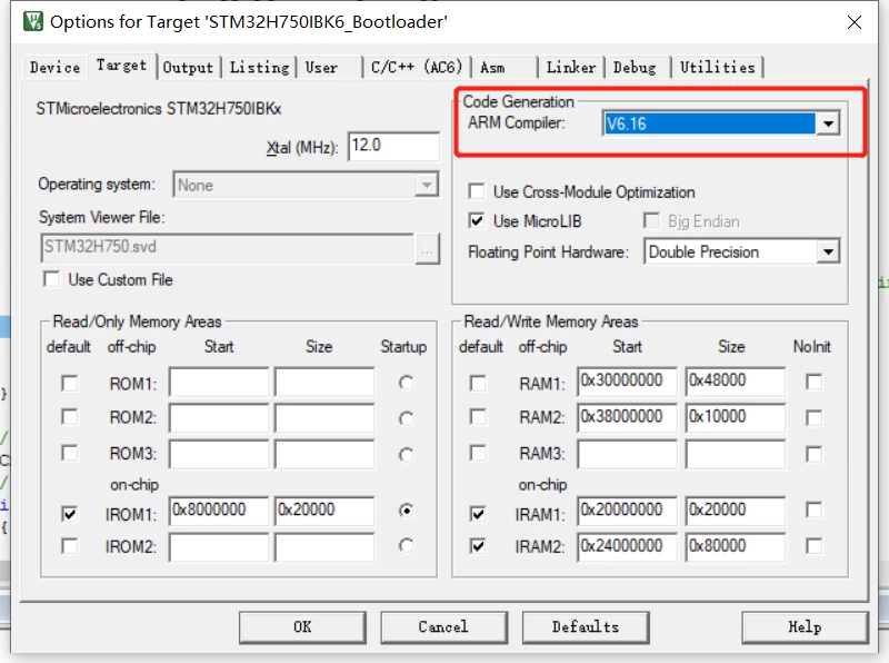

LOL, The reason is my customer bootloader is use "V6.16 ARM compiler", and the application uses "V5.06 ARM compiler".
Boot compiler:
App compiler:

Looks like jump to 0 (corrupted pointers or variables on stack?). Try to debug, single step from your bootloader to few first instructions of the app reset handler.

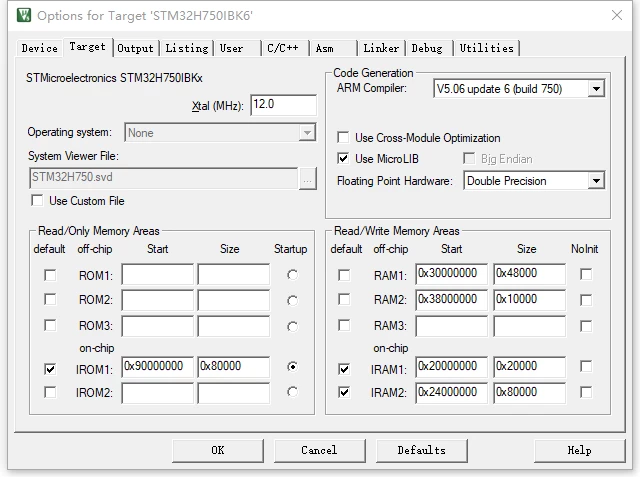

Boot compiler:
App compiler:
