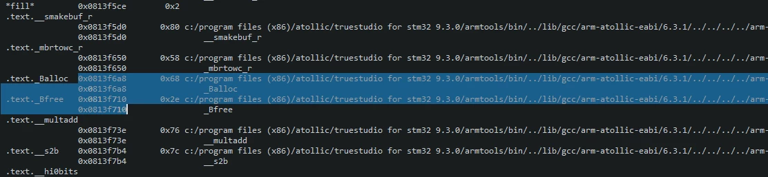

Jun 13, 2023 10:21 AM UTC
Hi wacakwek.jan,
thank you for you comments. The fault fall between Balloc and Bfree functions (see picture)
_legacyfs_online_stmicro_images_0693W00000dDgdHQAS.pngI'm using FreeRTOS with #define configUSE_NEWLIB_REENTRANT 0 because I'm using C standar library (no newlib). Analyzing the Call Stack, what I undertand is the standard C library is using reentrant functions since the most of them have the "_r" ending.
0x0813DC89 - _dtoa_r (Where the fault is triggered)
0x0813F702 - _Balloc
0x0813FD27 - __2db
0x081404D3 - __ssprint_r
0x0813A6B5 - __ssvfscanf_r
Do you suggest use any alternative to format float values without using the standar library?
Best regards
Bob S
Jun 13, 2023 11:44 AM UTC
When printing floats, printf does use malloc as @TDK​ mentioned. And malloc() is not re-entrant unless you take specific steps to make it so (newer versions of CubeMX/IDE make this easier but not foolproof). So malloc() is probably the failure point as @Community member​ said.
Even though you see the functions with trailing _r, if you don't define configUSE_NEWLIB_REENTRANT then FreeRTOS doesn't make space for the reentrant structure in its task blocks (I think - need to verify this). No matter WHICH library you are using (clib or newlib).
[EDIT] And using floating point in multiple tasks has its own set of pitfalls.
