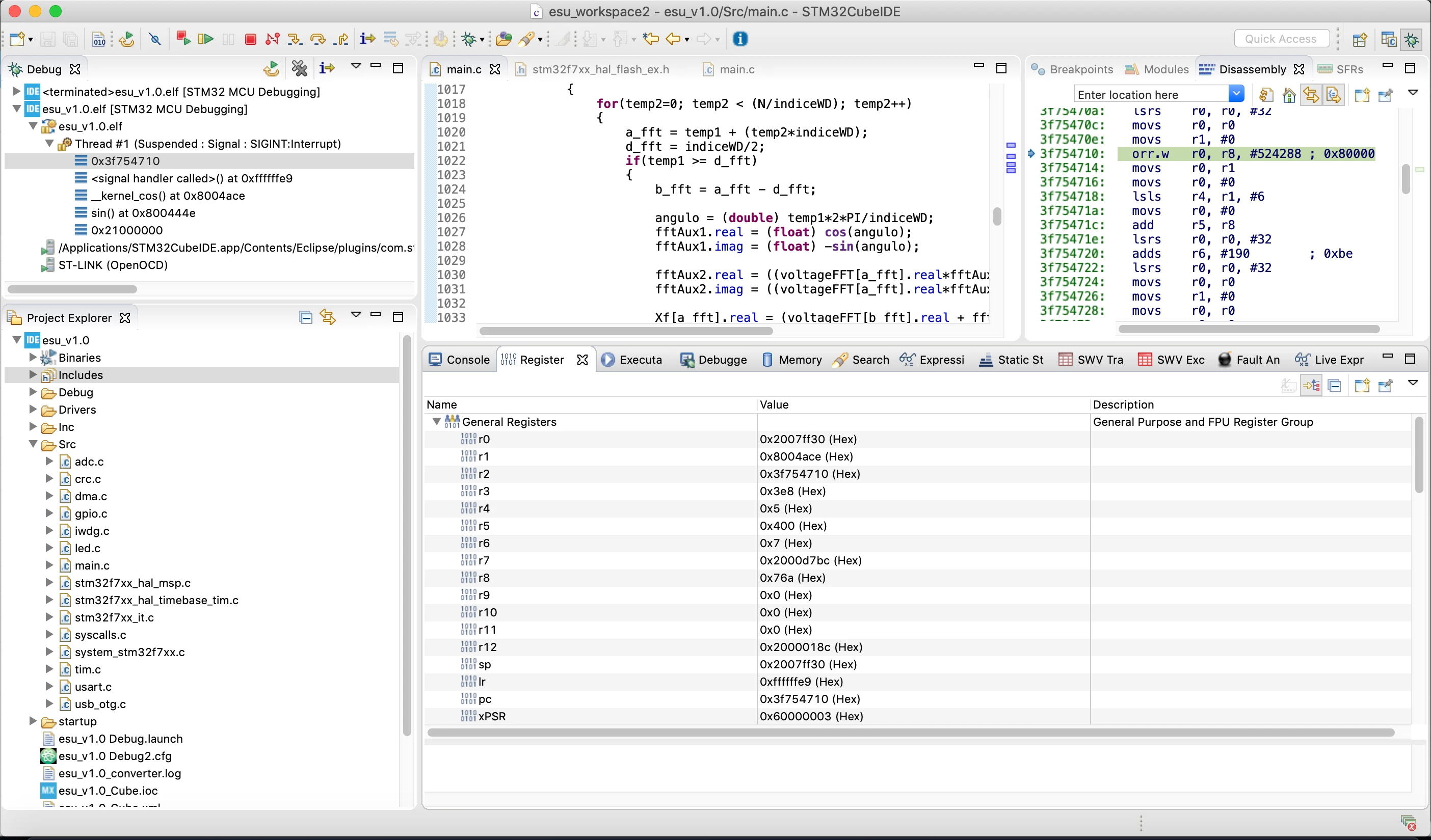

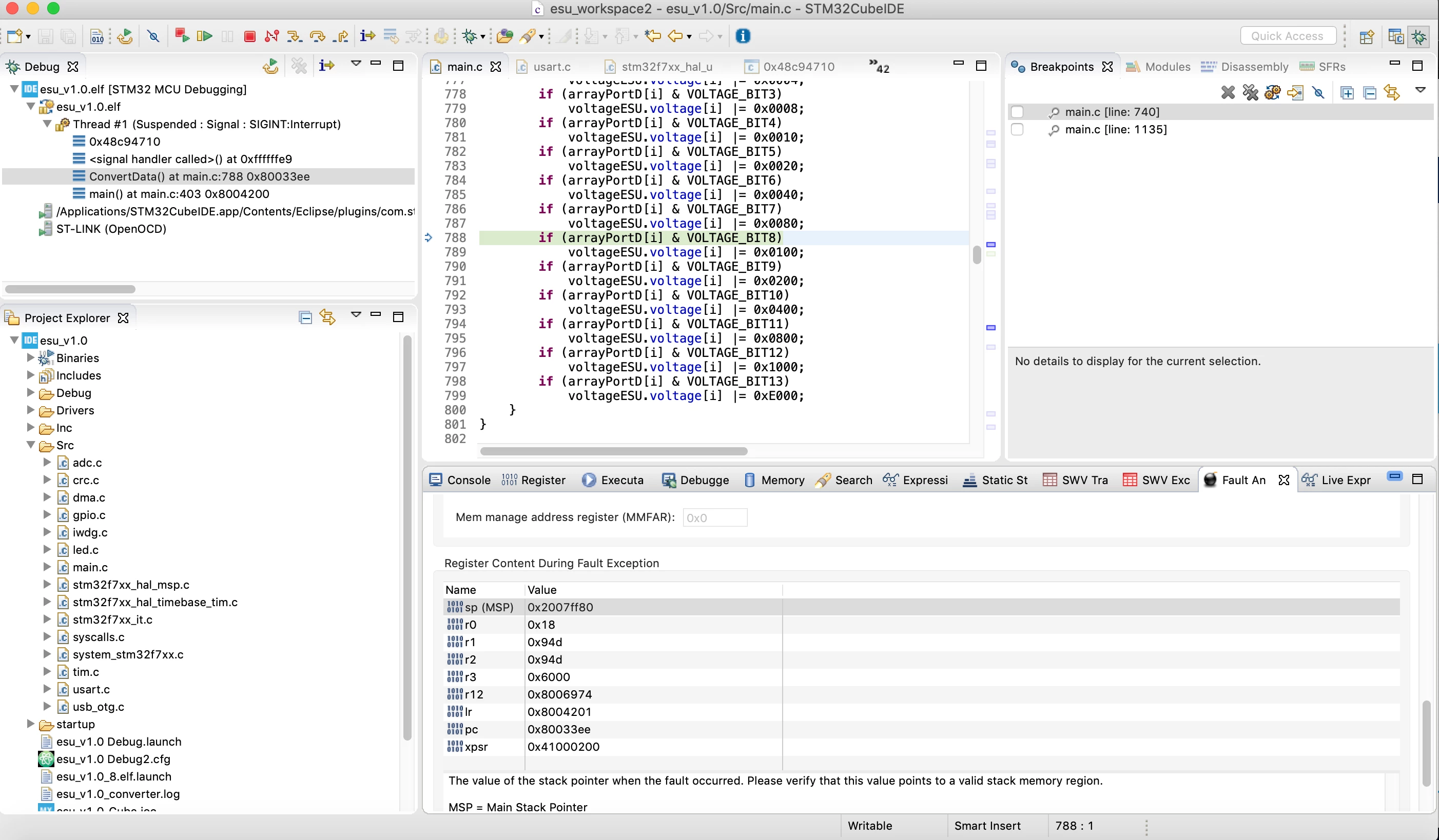

Hi, guys, here are the registers at the fault.
Is it something related to my stack been corrupted? How can I track it down?

Ok, that's a subset of the registers, the index is in R4 from the prior disassembly, but it is halfway through some code that is doing materially the same thing.
You'd perhaps fill the stack with a known pattern you can see in registers later, or check in a data dump of the stack area.
Determine which interrupts you have firing. Perhaps output a character to the terminal at entry/exit from those interrupts to identify any pattern to the failure.
Check your (excessive) use of auto/local variables in these interrupts and callbacks, and functions called inside them.

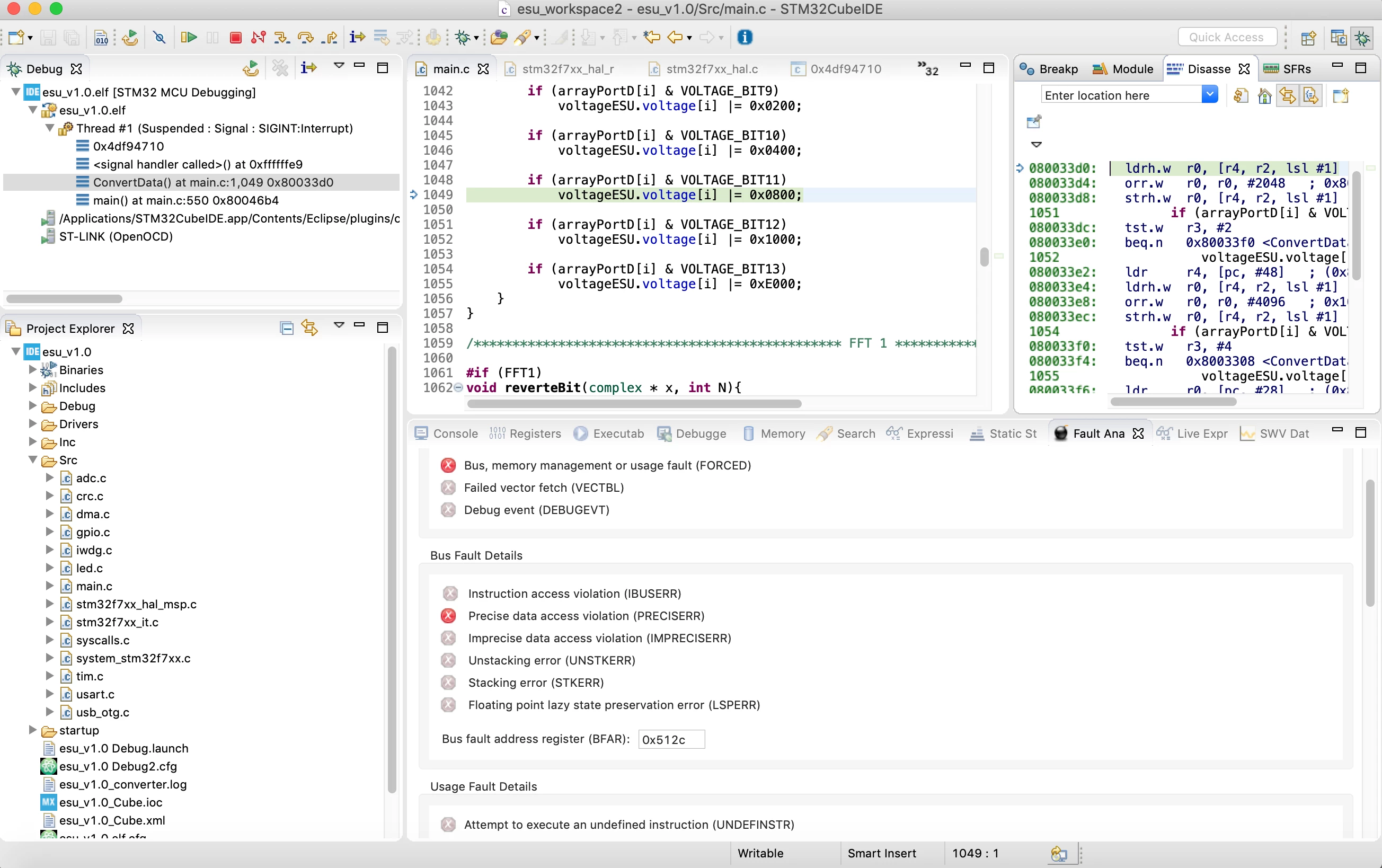

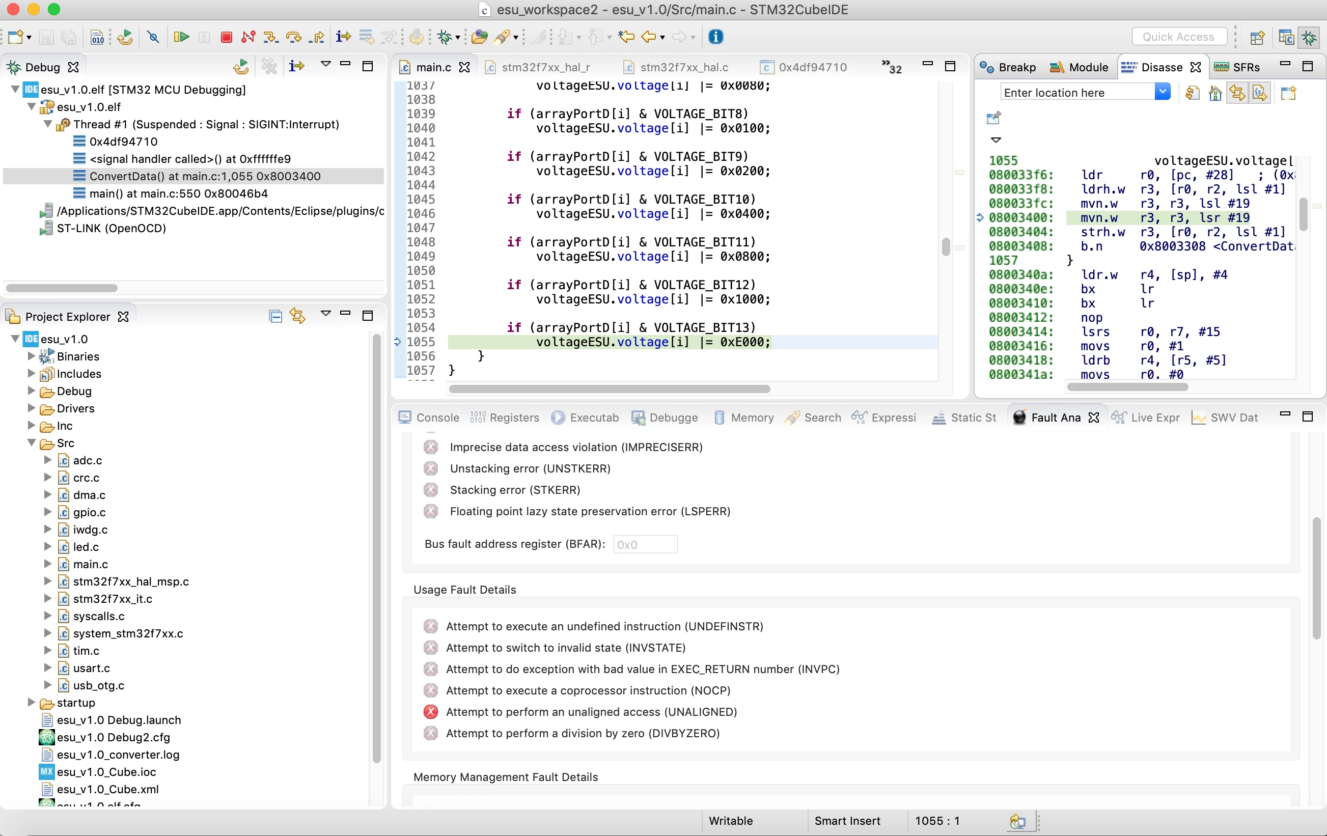

Hi, the only interrupt a use is a DMA interrupt, to get values from GPIO PortD register and send them to memory, is a big amount of data, like 10240 bytes.
Now the code is throwing even more the hard fault I don't now why.
I use a PWM to generate the dma request to get the data from GPIO PortD, after get the data I perform a FFT, at this time every single time I get a hard fault, apparently I don't see any errors in the code, here is the hard fault and the code.
The FFT function is in the CalcProcedure function.

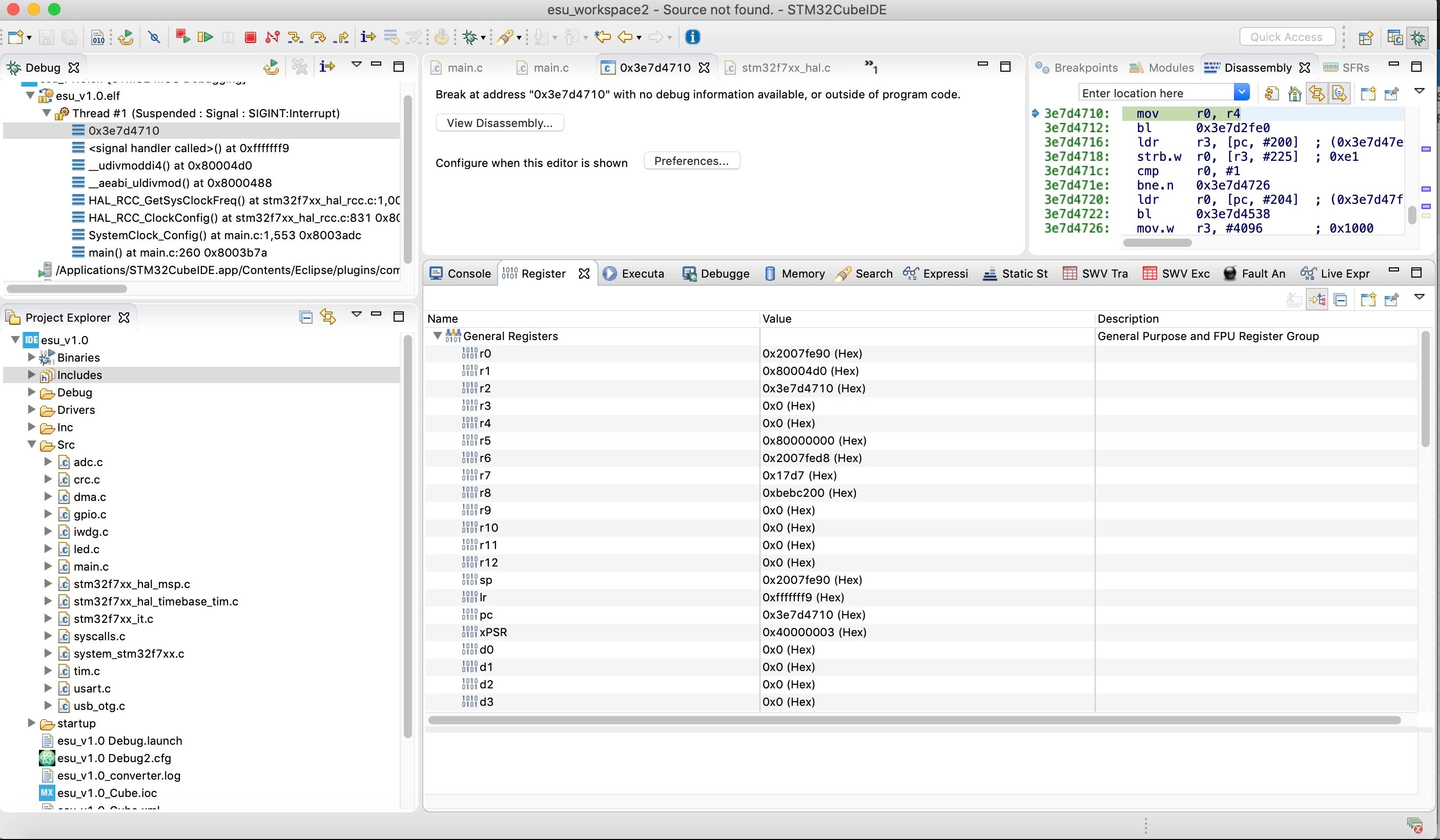

I thing maybe is some related with the RCC or system clock, or even my HSE clock, because some times I'm getting hardfault during HAL_Delay, or during clock init. Liked the photo below.
Tesla DeLorean
Guru
August 15, 2019
Looks to be branching to an invalid address (pc via r2), perhaps clash of stack/heap

generally it is an 'out of bounds' issue or power supply noise.
I would suggest its one of these lines, causing the problem:
a_fft = temp1 + (temp2*indiceWD);
could you check this value before you execute these lines ?
  1.
  2. Xf[a_fft].real = (voltageFFT[b_fft].real + fftAux2.real);
  3. Xf[a_fft].imag = (voltageFFT[b_fft].imag + fftAux2.imag);
then this line,
b_fft = a_fft + d_fft;
could cause it on these lines,
4. fftAux2.real = ((voltageFFT[b_fft].real*fftAux1.real) - (voltageFFT[b_fft].imag*fftAux1.imag));
5. fftAux2.imag = ((voltageFFT[b_fft].real*fftAux1.imag) + (fftAux1.real*voltageFFT[b_fft].imag));
I would check if a_fft and b_fft and voltageESU.len are within your array size. before you use them...
all the new linux core has hardset bounds or serious bounds checking.
The PWM would be asynchronous to the systick,
I guess that the PWM/DMA interrupt has priority over the systick, so thats why you can go into hardfault during systick.
do you have a call-stack view ?
should be able to backtrack the function that is causing the hardfault.
easily checked by commenting out lines that use the a_fft b_fft or d_fft or voltageESU.len indexing.
anyhow, if its not those variables, generally it is an index out of bounds in my experience.

I think there is a back-trace in the top left of post we are responding too. Not super helpful I'm afraid.
Most likely doing a pop { x,y,z, pc } and pulling this 0x3E7D4710 from there. Or bx r2

Basically, you're going to have to dig to understand what your system is DOING
Hard Faults are gross failures, failures at consistent/repeatable points suggest code or algorithm issues. Random/inconsistent points more to interrupt/call-back.
You're going to need to apply bisection debugging to pin-point or constrain failure to doing or not-doing specific things.
Understand what precipitates the failure, add sanity checks to catch the issue earlier and identify failure paths.
