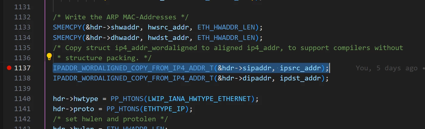

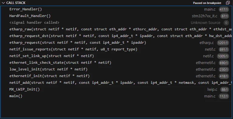

I'm quite new to STM32, and I'm trying to get LwIP up and running on my NUCLEO-H723ZG. No matter what I've tried so far, my board has always goes into HardFault, specifically during MX_LWIP_Init(), when the HAL calls etharp_raw(). Here is the full call stack for reference:
Here are the lines of code in etharp.c in which the HardFault occurs:

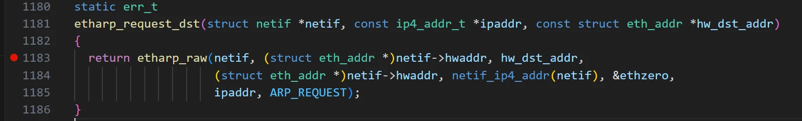

etharp_request_dst():
etharp_raw():
These are the steps I followed so far:

Dump out the register set from the fault, and the instructions there.
My guess would be that ipsrc_addr is an accessible memory address, at all, or misaligned.
Start by looking at what it is the processor doesn't like, not shot-gunning a whole bunch of code, heap or stack changes.
Once you know specifically what the processor is objecting too, work backward from there, perhaps adding telemetry output or sanity checks.

I was finally able to find the dumb error that caused the fault, I didn't set one of the MPU regions's "TEX field level" to "level 1". Now the STM32 connects to ethernet and I can ping the board when using a static IP address or DHCP.
Thanks for the help.
