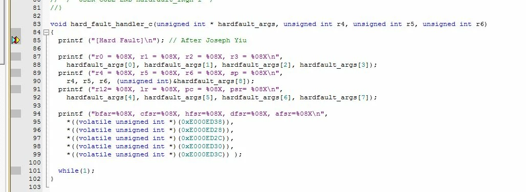

    In Keil, I do it this way..
    HardFault_Handler\
    PROC
    EXPORT HardFault_Handler
    TST lr, #4 ; Determine correct stack
    ITE EQ
    MRSEQ R0, MSP ; Read MSP (Main)
    MRSNE R0, PSP ; Read PSP (Process)
    MOV R1, R4 ; Registers R4-R6
    MOV R2, R5
    MOV R3, R6 ; sourcer32@gmail.com
    EXTERN hard_fault_handler_c
    B hard_fault_handler_c
    ENDP
    void hard_fault_handler_c(unsigned int * hardfault_args, unsigned int r4, unsigned int r5, unsigned int r6)
    printf (''[Hard Fault]
    ''); // After Joseph Yiu
    printf (''r0 = %08X, r1 = %08X, r2 = %08X, r3 = %08
    X'',
    hardfault_args[0], hardfault_args[1], hardfault_args[2], hardfault_args[3]);
    printf (''r4 = %08X, r5 = %08X, r6 = %08X, sp = %08
    X'',
    r4, r5, r6, (unsigned int)&hardfault_args[8]);
    printf (''r12= %08X, lr = %08X, pc = %08X, psr= %08
    X'',
    hardfault_args[4], hardfault_args[5], hardfault_args[6], hardfault_args[7]);
    printf (''bfar=%08X, cfsr=%08X, hfsr=%08X, dfsr=%08X, afsr=%08
    X'',
    *((volatile unsigned int *)(0xE000ED38)),
    *((volatile unsigned int *)(0xE000ED28)),
    *((volatile unsigned int *)(0xE000ED2C)),
    *((volatile unsigned int *)(0xE000ED30)),
    *((volatile unsigned int *)(0xE000ED3C)) );
    while(1);

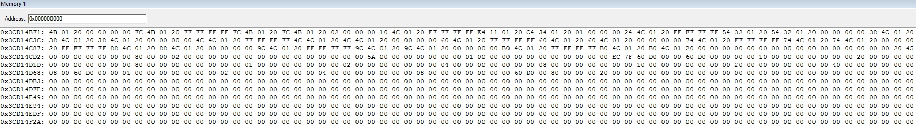

    Thank you for your answer but I don't undestand what I have to do. I'm a junior programmer and there are some functionalities which I don't know but I would like to learn.
    ''You should fill the stack with a pattern you can recognize in the debuggers ''Memory View'' and confirm how much you are using, and the state of the return addresses it is about to pop off the stack.
    I've open Memory 1 tap view but I don't know what I have to view. If you want tell me is that in which memory address the code is all 00, it starts in 0x3CD14CB3.

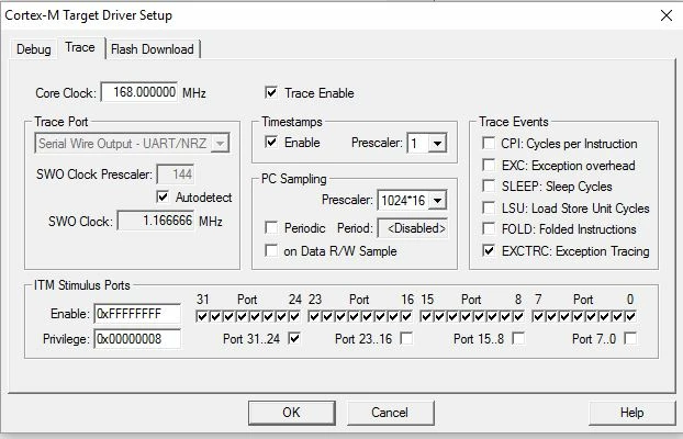

    Yestarday I had some problems to replay you. I'm thirty but only 8 month ago I'm working with STM32 devices. I'm new in Keil and with this environment. I've tried your advice, but I have other problem. I can't printf. I have an ULINK2/ME which can SWD but I don't know why when the system arrives at printf it hangs. 0690X000006037ZQAQ.jpg I've configure the Trace as: 0690X00000603AwQAI.jpg Because my crystall is 8MHz and my core clock is 168MHz as:
    RCC_OscInitStruct.OscillatorType = RCC_OSCILLATORTYPE_HSE;
    RCC_OscInitStruct.HSEState = RCC_HSE_ON;
    RCC_OscInitStruct.PLL.PLLSource = RCC_PLLSOURCE_HSE;
    RCC_OscInitStruct.PLL.PLLM = 8;
    RCC_OscInitStruct.PLL.PLLN = 336;
    RCC_OscInitStruct.PLL.PLLP = RCC_PLLP_DIV2;
    RCC_OscInitStruct.PLL.PLLQ = 7;
    HAL_RCC_OscConfig(&RCC_OscInitStruct);
    What is it happen? Certainly the stack is defined as 0x900

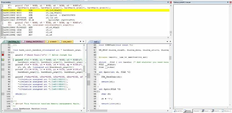

    Ok, but where does is ''hang'', the debugger provides a means to stop execution and inspect the instructions and state.
    I suspect you haven't provided any hosting/retargeting of the stdio to get it to the SWV channel.
    // Hosting of stdio functionality through SWV - Serial Wire Viewer
    #include <
    rt_misc.h
    #pragma import(__use_no_semihosting_swi)
    struct __FILE { int handle; /* Add whatever you need here */ };
    FILE __stdout;
    FILE __stdin;
    int fputc(int ch, FILE *f)
    ITM_SendChar(ch);
    return(ch);
    int fgetc(FILE *f)
    char ch;
    ch = '?';
    return((int)ch);
    int ferror(FILE *f)
    /* Your implementation of ferror */
    return EOF;
    void _ttywrch(int ch)
    ITM_SendChar(ch);
    void _sys_exit(int return_code)
    label: goto label; /* endless loop */

    Hi Clive,
    Ok, thank you! Now doesn't hang but doesn't print anything... :'(
     I've configured the Trace too.
