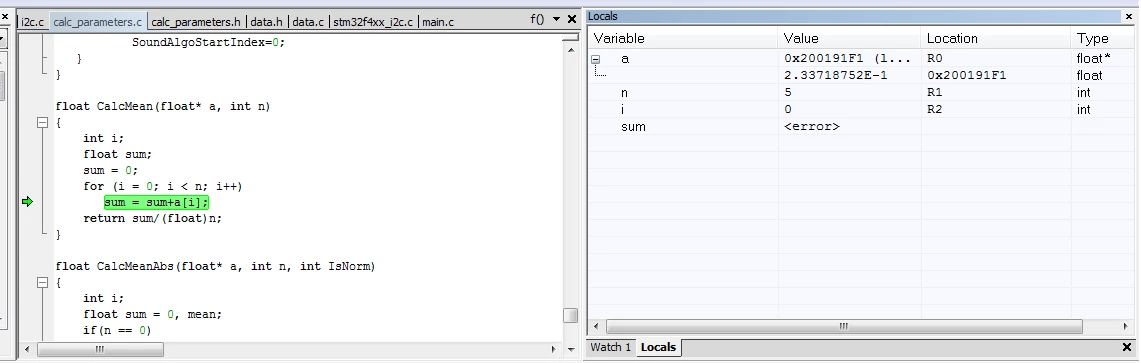

I'm using the STM32F4 on the discovery evaluation board.
I wrote a simple function that calculates the mean of a vector. When the code is starting to make the summation it goes to HardFault_Handler...
Here is the mean function, a moment before the exception:
When I hit F10, the code goes to void HardFault_Handler(void) at stm32f4xx_it.c.
Here is the call of the function:
SNR = CalcMean((float*)local_data_buffer.data_struct.handVISNRBuff,5);
Any Ideas?!
Thanks!
Yoav

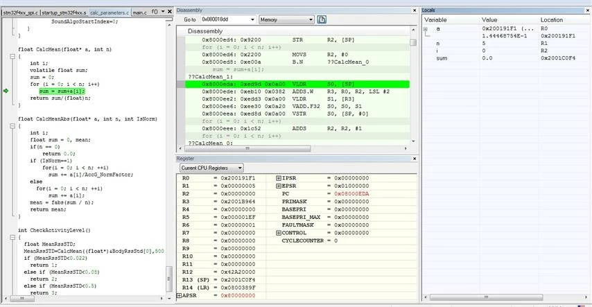

    Posted on May 20, 2013 at 12:18
    Hi again,
    Attached is a print screen of the code, registers, locals, and assembly code.
    When I hit F10 I get the hard fault exception.
    I'll appreciate your help.

    Tesla DeLorean
    Guru
    May 20, 2013
    Posted on May 20, 2013 at 16:58
    Honestly it still looks to be a problem with the FPU.
    Check SCB->CPACR
    Check __FPU_PRESENT and __FPU_USED defines.
    In main(), something like
      printf(''CPACR:%08X  FPU:%d %d\n'', SCB->CPACR, __FPU_PRESENT, __FPU_USED};

    Tesla DeLorean
    Guru
    May 21, 2013
    Posted on May 21, 2013 at 16:26
    Other ideas, please...?
    Getting to the point where I'd need to see the project, I can't glean enough information from the screen shots. The stack pointer and memory addresses look reasonable at a glance.
    Perhaps it's a FPU_IRQHandler issue rather than a hard fault. Perhaps your array contains values that aren't valid floating point representations?
    Suggest also you look at getting your Hard Fault handler to display diagnostic output, see the Joseph Yiu examples.
