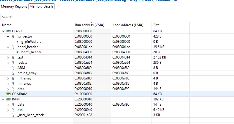

Hi amazing community.
I am developing a custom bootloader for stm32f429 .
I have touched the linker file that i show here

The idea it is to have the following memory map
* Per il micro STM32F429 -
| FLASH (2048K) |
| | 0x08000000 |
| 16K | Bootloader Section |
| | 0x08004000 | Bootloader 64k
| 16K | |
| | Bootloader Header (.bl_header) |
| 16k --- |
| | 0x08010000 |
| 64k | Application Section |
| | Startup Code (.isr_vector) |
| 128k... | 0x08020000 |
| | Application Header (.app_header) |
| | | app 2048-64k
| | Program Code (.text) |
| | Constant Data (.rodata) |
| | ARM Exception Handling (.ARM) |
 Now i am working on the bootloader project but when i click on debug after the reset handler i have immediatly the hardware fault problem
Do you see any issues ?
Thans a lot

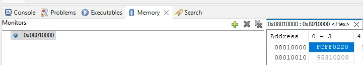

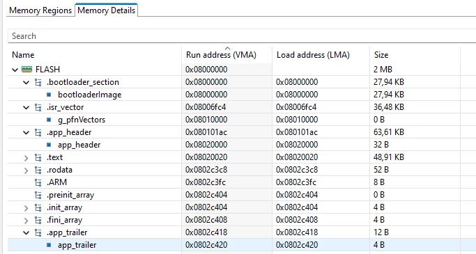

SGasp.1
SGasp.1Author
May 17, 2024
Hi @tjaekel .
Yes the bootloader was missing but now i have imported moreover the starting ram address was wrong .
Moreover i added the following instructions
/*vector table remap*/
static void VetcorTblRemap(void)
 /*vector table re map*/
 SCB->VTOR = (uint32_t)&g_pfnVectors;
 __enable_irq();
/* USER CODE END 0 */
 * @brief The application entry point.
 * @retval int
int main(void)
 /* USER CODE BEGIN 1 */
	VetcorTblRemap();
 /* USER CODE END 1 */
and now the code at least it is working.
But the interrupts are not working anymore and i don't understand why.

and this is the memory map  from cube ide (current situation)
and this is what i want to obtain
| FLASH (2048K) |
| | 0x08000000 |
| 16K | |
| 16k --- |
| | 0x08010000 |
| | | app 2048-64k
