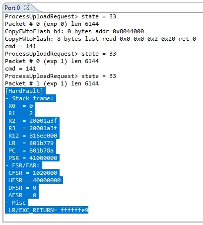

    MFend
    Mar 7, 2019 1:10 PM UTC
    Here are the SCB registers and the output of the Handler (not much, because i don't have the assembler code)

    Mar 7, 2019 1:52 PM UTC
    http://www.keil.com/appnotes/files/apnt209.pdf
    Quick glance: looks like usage fault/unaligned.

    MFend
    Mar 10, 2019 2:06 PM UTC
    The dump is helpful - I'm checking the code around LR and PC...
    MFend
    Mar 10, 2019 2:40 PM UTC
    And an alignment error it was...
    I tried to cast a BYTE array to a 64-byte pointer.
    Now with the memcpy to a 64-bit variable (without the cast, there is no HardFault.
