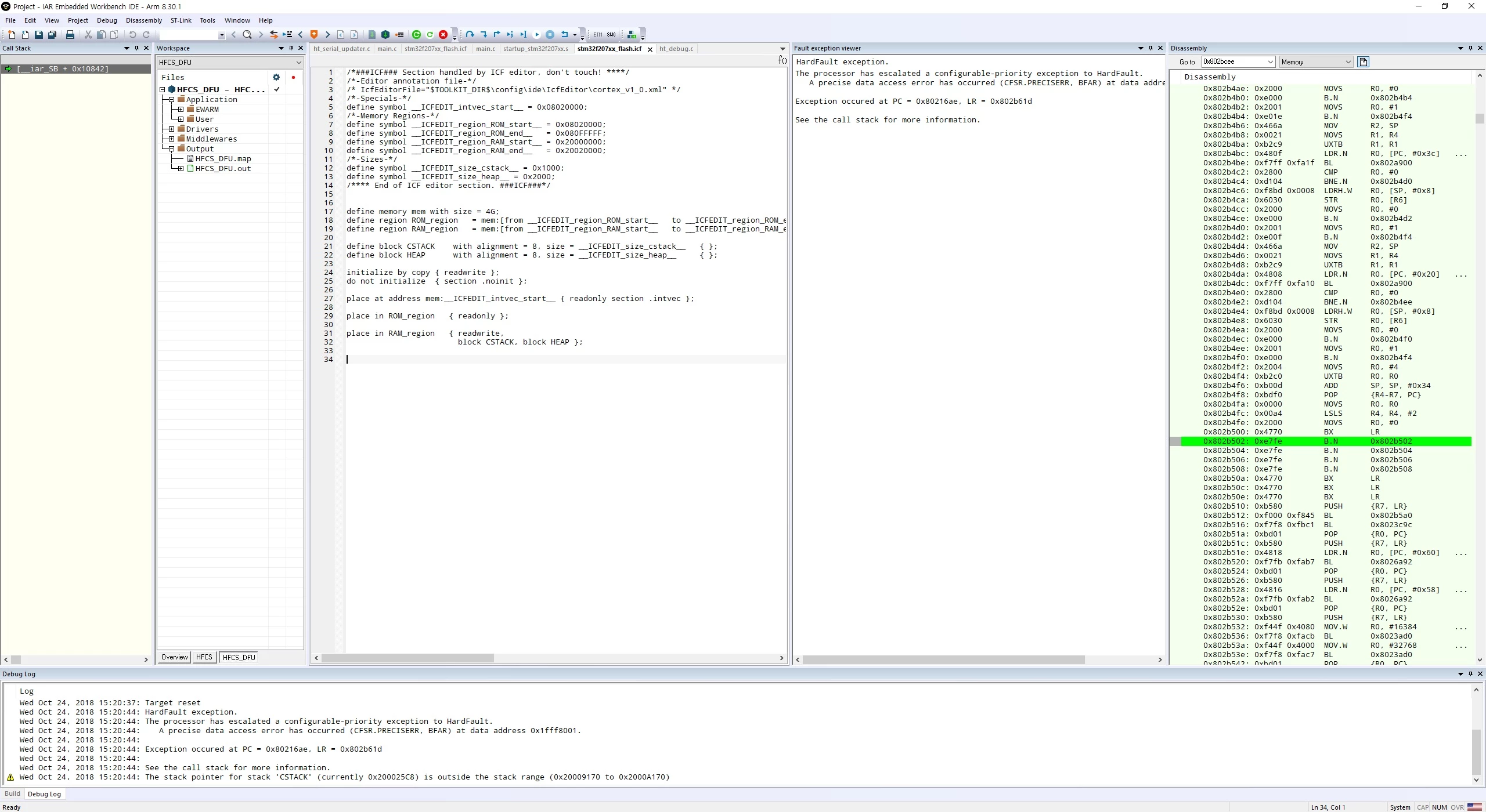

I make boot loader for jump to 0x08020000
And, I make program that start from 0x08020000, also same vector table address(0x08020000)
It works well, but sometimes(when program modified), it doesn't work
I use debugger, and get result below
//Fault exception viewer
HardFault exception.
The processor has escalated a configurable-priority exception to HardFault.
  A precise data access error has occurred (CFSR.PRECISERR, BFAR) at data address 0x1fff8001.
Exception occured at PC = 0x80216ae, LR = 0x802b61d
See the call stack for more information.
//Debug Log
The stack pointer for stack 'CSTACK' (currently 0x200025C8) is outside the stack range (0x20009170 to 0x2000A170)
What is the problem?

    Have you tried to pinpoint the exact location (instruction) where the fault happens ?
    Perhaps you tried to access peripherals not yet enabled ?

    But, I don't know what i can
    I try to debug program only, it works well.
    I try to set program address and vector table 0x0800 0000, it works well.
    Therefore, I guess set register or interrupt error when jump from 0x08000000(boot loader) to 0x08020000(program)
    I made program it works well,
    And, add 2lines in any function, uint8_t buf[10] and memset ( buf, 0x00, 10)
    then, program halt and same issue
    It work well at 0x08000000 or 0x08020000 starting by debugger
    It's so hard to solve

    Does the application set it's own vector table properly ?
    Sounds like it uses the BL table.
    In a similar application I have, the application sets the VTOR as one of the very first things in the reset handler.

    I set icf file
    define symbol __ICFEDIT_intvec_start__ = 0x08020000;
    /*-Memory Regions-*/
    define symbol __ICFEDIT_region_ROM_start__ = 0x08020000;
    define symbol __ICFEDIT_region_ROM_end__  = 0x080FFFFF;
    I set stm32f2xx.c file
    ​#define VECT_TAB_OFFSET 0x20000
    void SystemInit(void)
     RCC->CR |= (uint32_t)0x00000001;
     RCC->CFGR = 0x00000000;
     RCC->CR &= (uint32_t)0xFEF6FFFF;
     RCC->PLLCFGR = 0x24003010;
     RCC->CR &= (uint32_t)0xFFFBFFFF;
     RCC->CIR = 0x00000000;
     SCB->VTOR = FLASH_BASE | VECT_TAB_OFFSET; /* Vector Table Relocation in Internal FLASH */
    #define FLASH_BASE      0x08000000U /*!< FLASH(up to 1 MB) base address in the alias region             */
