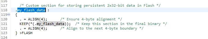

The adress of the flash data is allocated in the .ld file:
Aand used:
__attribute__((section(".my_flash_data"))) uint32_t flash_data[2];

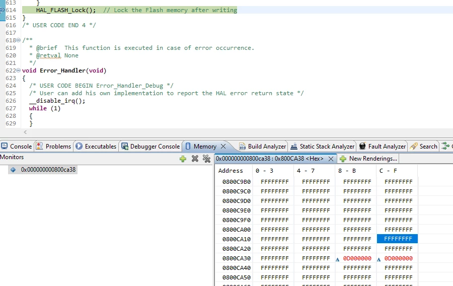

After i run the code, it runs into a hardfault exception. I was able to debug it.
I can see in the Memory, that the write was succesfull:
After the HAL_Flash_Lock(); returns, the program goes into hardfault exception interrupt, the strangest thing is, that it does not happen at the same time between tries. Sometimes it goes right into hardfault, sometimes it executes some instruction, and then goes into hardfault.

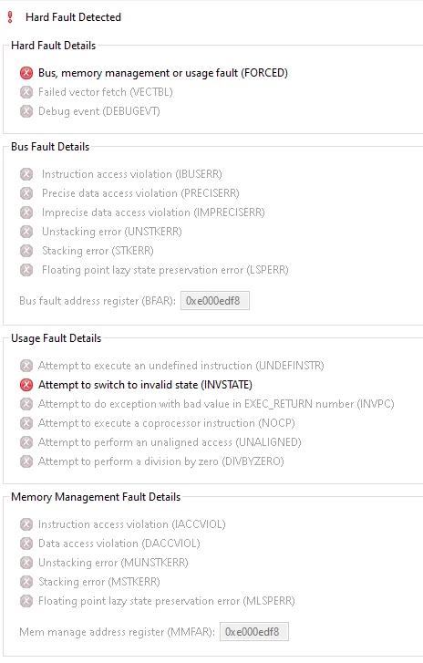

Why do you use __disable_irq() around the write?
When the hardfault occurs, have you tried to analyze it (what is the original exception reason) ?
GergoKatoAuthor
September 17, 2024
I wa trying to solve the problem, and in an other forum they suggested that the issue is maybe that an interrupt interrupts the flash write, causing an error. But it did not solved the issue.
The Fault analizer states this:

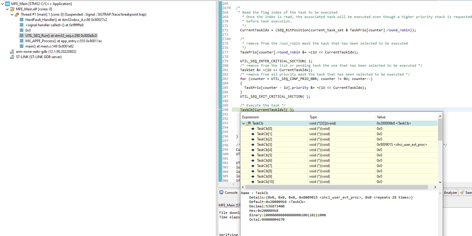

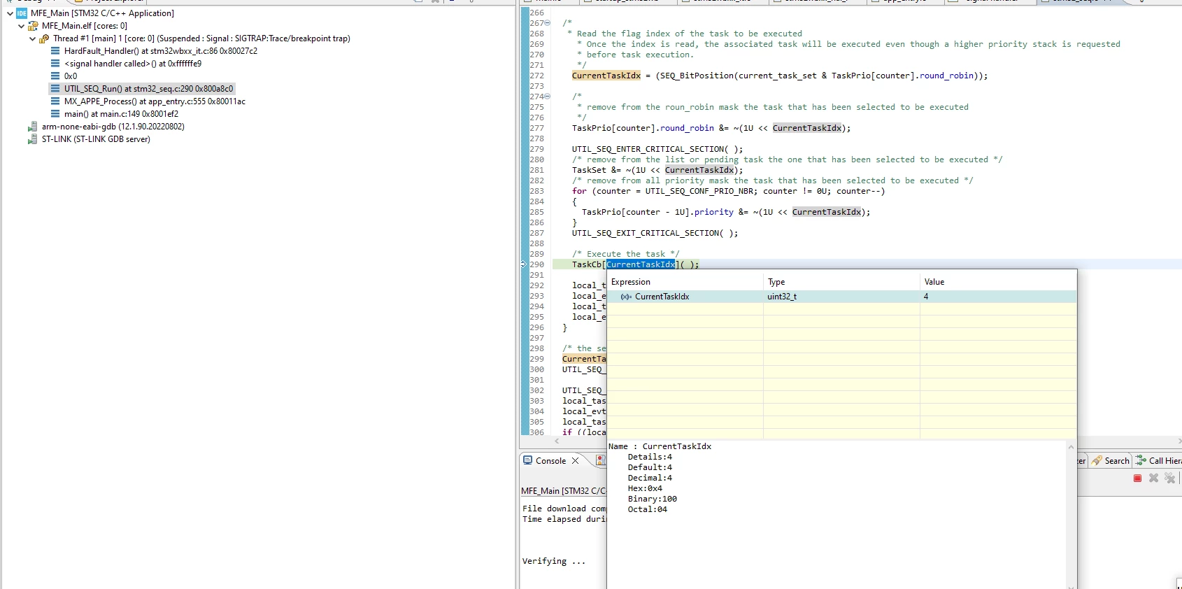

I finally was able to detecte where is the Haurdfault comed from:
After writing, the main loop calls  MX_APPE_Process(); the tries to start a task, but the index is pointing to a place where there is no task:
After calling that, the program goes to HardFault
