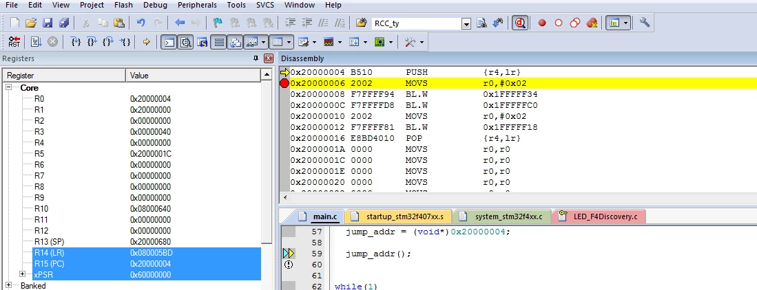

I am using stm32f407 discovery board and when i tried to execute the code stored in the SRAM i am getting hardfault exception . the instructions are indeed valid.
i have attached the screenshot which shows the PC, SP, and disassembly code. please help me solve this issue.
In this window the processor is ready to execute the PUSH instruction  , and when i hit ''step in'' button i goes to hardfault handler.

How do you jump to your RAM code ?
Are you aware of the ARM/Thumb code difference, and how the core distinguishes both ?

Thanks for your replay . if i understood correctly cortex M4 uses Thumb2 and its a mix of ARM 32 bit and Thumb 16 bit instruction set. so when it tries to execute the first instruction ,, do you mean it could not able to recognize the instruction ? why would that happen ? because its a thumb 16 bit instruction right ? please correct me if i am wrong

The branches to subroutines look like they will be problematic..
Also jump_addr of 0x20000004 will be a problem, should be 0x20000005, as the core can't execute 32-bit code, and WILL fault.
It will help significantly working at this level of processor functionality to read and understand the core's documentation.
This means, the LSB of the jump address must always been set on a Cortex M, this bit serves to distinguish between ARM and thumb code.
The Cortex M does not support ARM code, and will hardfault on it.
Usually, the compiler does this for you.
