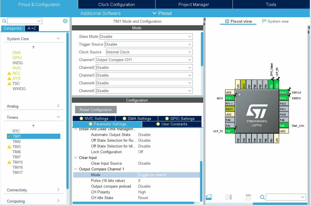

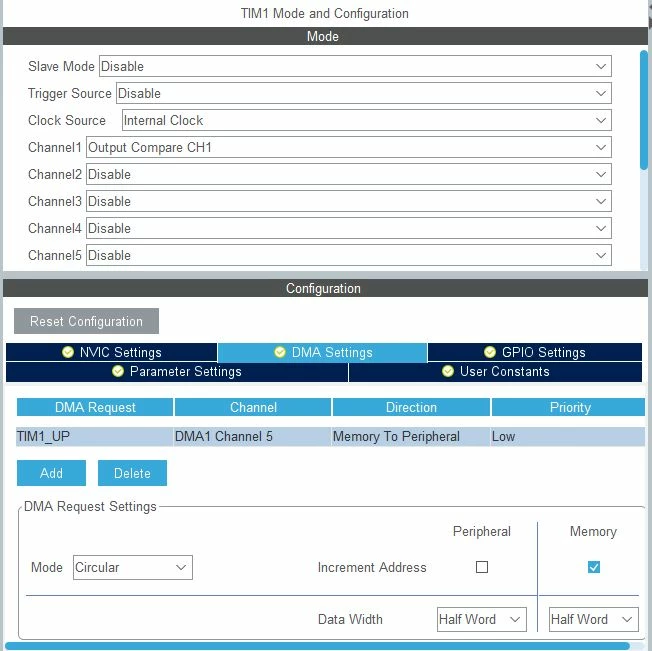

I'm using timer 1 in OC mode with toggling the output. I also want to change the timer overflow value with the values predefined in the buffer.
I define buffer as:
uint16_t data[5] = { 50, 50, 100, 50, 50};
Then in main I call:
HAL_TIM_OC_Start_DMA(&htim1, TIM_CHANNEL_1, (uint32_t *) data, 5);
Hardfault strikes inside HAL_TIM_OC_Start_DMA:
htim->hdma[TIM_DMA_ID_CC1]->XferCpltCallback = TIM_DMADelayPulseCplt;
htim->hdma[TIM_DMA_ID_CC1]->XferHalfCpltCallback = TIM_DMADelayPulseHalfCplt;
My question is how avoid this.
Attached Cube initialization of TIM and DMA.

Ok, now it works.
I start timer and OC separately like this and got desired pulse train:
 HAL_TIM_OC_Start(&htim1, TIM_CHANNEL_1);
 HAL_TIM_Base_Start_DMA(&htim1, (uint32_t *) data, 10);
Thanks everybody!
