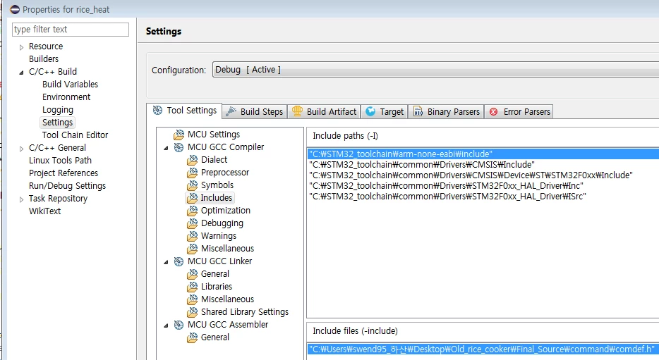

    Md Mubdiul Hasan
    Nov 17, 2016 1:49 AM UTC
    Posted on November 17, 2016 at 02:49
    Dear Sir AvarTar,
    My apologies for misinterpreting things which should be explain  correctly.
    The options for target, I did connect the folder not files.
    Yes, I did copy that file in the HAL library folder and still its unsolvable.
    From now on, I will carry my question in Eclipse based.
    There might me some issues relating the project setting, and may be I am adding same files which already exists in my project try or include path folder!

    AvaTar
    Senior III
    Nov 17, 2016 6:59 AM UTC
    Posted on November 17, 2016 at 07:59
    Viewing the image you posted, the path separation characters don't look good.
    When I look at my configurations, it's either '\' or '/'.

    AvaTar
    Senior III
    Nov 17, 2016 9:34 AM UTC
    Posted on November 17, 2016 at 10:34
    > Or do you mean in this way... 'C:\STM32_toolchain\common\Drivers\CMSIS\Device\ST\STM32F0xx\Include'?
    That is how it looks like on a Windows platform.
    > Do you mean its should be with a bar like / ?
    Other platforms (Unix and Unix-like's) use the (forward) slash.
    Eclipse is platform-independant and can deal with both, especially with '/' on Windows platform.
    I have the suspicion your ''missing'' file is the very first include file the toolchain is going to search.
    Can you post the full build log (including the call command line) ?
    In Eclipse, it is the output that ends up in the ''Console'' window.

    AvaTar
    Senior III
    Nov 18, 2016 6:31 AM UTC
    Posted on November 18, 2016 at 07:31
    >In file included from ..\src\main.c:8:0:
    >C:\STM32_toolchain\common\Drivers\CMSIS\Device\ST\STM32F0xx\Include/stm32f0xx.h:167:3: error: #error ''Please select first the target STM32F0xx device used in your application (in stm32f0xx.h file)''
    You just need to do as it says.

    You something similar in the stm32f0xx.h file, for the STM32F0.
    Define the macro that matches the MCU derivate you use.
    The best place is in the project settings, with ''Preprocessor Macros''.
    I expect the Keil uVision ''wizard'' to do this for you when creating a new project.
