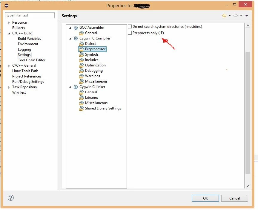

    AvaTar
    Senior III
    Nov 9, 2016 10:06 AM UTC
    Posted on November 09, 2016 at 11:06
    > Still working in 3 different, IDE, Eclipse, Coocox and Keil.
    Coocox is also Eclipse-based, at least it was the last time I had a look (and discarded it).
    > 1.Do you talking about setting in Preferences> c/c++>makefile error persor?
    I never tried to mess with the parser settings, and simply ignored those parser remarks. Just to clarify, I experienced the same issue with Eclipse-based toolchains for the x86 family ...
    > 2. Where you wanted to adding -E?
    > 3.Preprocessed output setting is where?
    On a plain Eclipse it looks like this (right-click on the project, select ''Options...''):
    The generated (preprocessed) source ends up somewhere in the Debug sub-path (for the Debug build).
    > 4. For code generation, dont you suggest cubemx?
    For several F0 variants, you should (still) have the option to download and use the ''old'' SPL. It is a much thinner and ''much less awkward'' library, and proven to be less buggy than Cube. The free EmBlocks/EmBitz toolchain supports this SPL ''out-of-the-box''.
    For newer MCUs, you can just resort to ''register-hacking'', or free libs (if you find one ...).
    IMHO CubeMX is an twisted mess - but this is just my personal opinion.

    AvaTar
    Senior III
    Nov 10, 2016 7:19 AM UTC
    Posted on November 10, 2016 at 08:19
    > People says , Coocox is dead really.
    Perhaps not dead, but nothing for me.
    > Those errors I got before, still  stm32f0xx.h is exists on the path.
    This file should be in one of the defined include paths - these are the one's given with ''
    -I
    '' in the console:
    ''-IC:\\STM32_toolchain\\arm-none-eabi\\bin'' ''-IC:\\STM32_toolchain\\bin'' ''-IC:\\STM32_toolchain\\common\\Drivers\\STM32F0xx_HAL_Driver\\Inc'' ''-IC:\\STM32_toolchain\\common\\Drivers\\STM32F0xx_HAL_Driver\\Src'' ''-IC:\\STM32_toolchain\\lib\\gcc'' ''-IC:\\STM32_toolchain\\arm-none-eabi\\lib''
    The stm32fxxx.h file(s) are usually to find in the folder:
    ...\STM32Cube_xxx\Drivers\CMSIS\Device\ST\STM32Fxxx\Include
    The ''xxx'' part of this name depends on the actual device. I miss this path in your list.
    I can't really give much support for Coocox, since I don't have/use it - for several (obvious) reasons.
    In your place, I would try to migrate to a toolchain/IDE you feel comfortable with. You are not the only one struggling with Eclipse...
