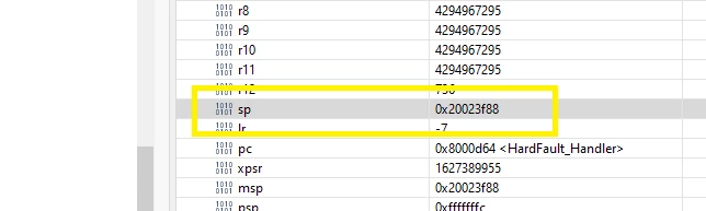

On one hand, I built an app that uses I2C, 2 UARTS, ADCs, captures PWM, provides PWM. All of them rely heavily on the use of DMAs. This app gives good results without any apparent issue.
On the  other hand, I built a test app on the same target to drive a display using LVGL 9.2.2. It seems to work too.
So far, so good... Now I put both together: the result produces an hard fault with STKALIGN and UNALIGN_TRP bits set.
I suspect an overflow somewhere.
As the app is pretty big, I started to strip the code as much as possible while keeping the hardfault. Stripping code allowed the app to be compiled without optimization hoping this will help resolving.
This leads to a single module that is provided below.
Some elements:
- app is pre-configured using CubeMx.
- in the provided code, nearly any change will make the hard fault disappear (at least for minutes, I don't have the oppportunity to let the app run for hours for each change I did).
- pwm capture and pwm outputs are not enabled in the code. But if I remove one of them from the ioc configuration, the hard fault disappears.
After several days of struggling, I'm requesting some help on how I could solve or investigate deeper the failure.
Here's the code for the display module and how it is called, a zip for the whole minimal project if other pieces of information are needed, also screenshot of hard fault and cubeMx.
Thanks
Julien

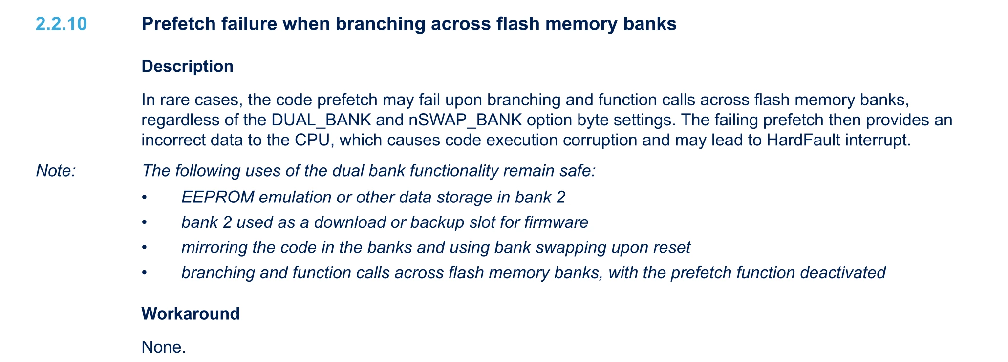

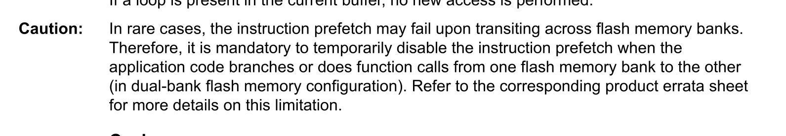

You say your code is "big". Is it by a chance bigger than 128K for a 256K part / bigger than 256K for a 512K part?
Maybe you are running into a silicon errata regarding dual-bank flash. Basically when you have dual-bank flash, you can not have code in both of the banks. Otherwise the processor core crashes in weird ways, typically hardfault.
and also in the reference manual, section 3.3.5:
The workaround is to disable prefetch ( `__HAL_FLASH_PREFETCH_BUFFER_DISABLE();`), which will probably cost you a lot of performance. For me it seems that disabling DUAL_BANK bit in the option bits resolved the one crash I was having, but idk if it is stable this way.

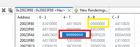

Andrew Neil
Feb 28, 2025 10:57 AM UTC
JulienD
JulienDAuthor
Feb 28, 2025 4:15 PM UTC
Hello Andrew,
Thanks for the interesting pointers. Unfortunately cortex-M0+ offer less features than M3-M4.
Anyway! Here's what I get:
SP : 0x2002 3F88
Extract from memory dump at this address:
If I did everything well, the instruction that causes the error should be at the address 0x60 which, based on the documentation is part of the information block and is an alias of 0x8000060 which is somewhere in the interrupt vector. The 18th (0x60 / 4) element of this vector is RTC_TAMP_IRQHandler.
1- Is that correct? It's suspicious to me :S
2- If yes, what does that mean?
waclawek.jan
Mar 3, 2025 1:37 PM UTC
There are 8 words pushed at the stack at ISR/fault handler entry; the last of which (which you've highlighted) is content of the xPSR register. The PC is stacked one before that. You also have the memory dump set to display MSB first (Eclipse's default, I won't comment on this here), so the stacked PC is 0x2000A40C. (In your initial post, with different version of the program, it's 0x2000160C.) This is in RAM. It's unlikely you have program deliberately in RAM, so this is probably consequence of jumping through an incorrectly set function pointer.
Try to go back in stack and look what's at FLASH addresses. Try to set breakpoints on those addresses, run the program up to there and then single-step through those points to see, where does the fault occur.

braczBest answer
Visitor II
Mar 2, 2025 7:19 PM UTC
JulienD
JulienDAuthor
Mar 5, 2025 4:37 PM UTC
And the winner is.... bracz!
Thanks a lot.
Thanks also to Andrew, Clive and Jan (by order of apparition), your help is always  valuable.
