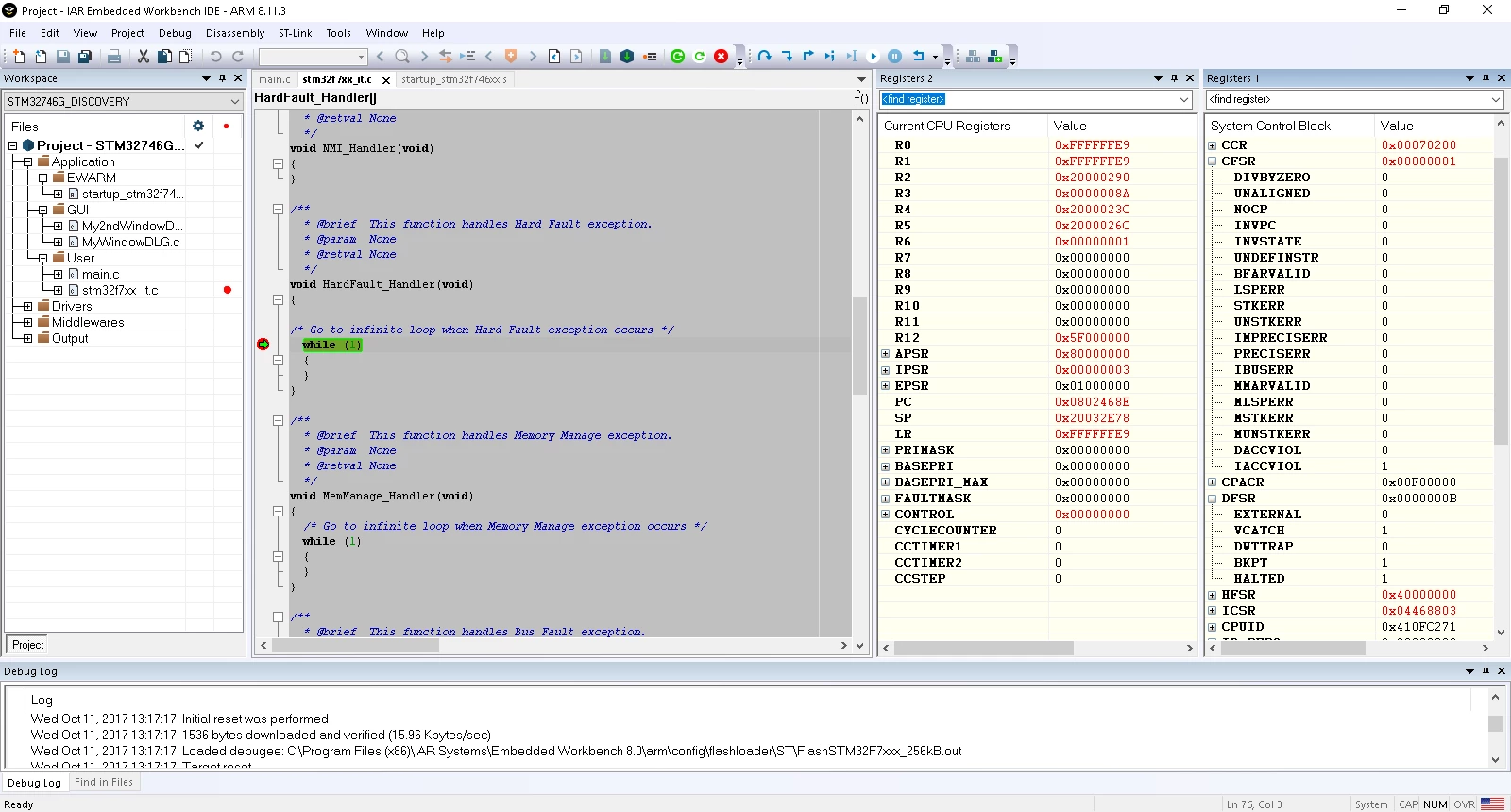

Compiler:           IAR Workbench v8.11.3
Graphics:           STemWin
Hardware:          STM32746G Discovery Board
HAL Version:     V1.8.0
Demo Project:   C:\STM32Cube_FW_F7_V1.8.0\Projects\STM32746G-Discovery\Applications\STemWin\STemWin_HelloWorld
Problem:
I have created a simple project based on the “STemWin_HelloWorld� example for the STM32746G Discovery Board. I have created two screens with a button on each. The button on each screen loads the other screen, and visa-versa. If you switch back and forth the screens a couple of times the program gets stuck in the “void HardFault_Handler(void)� routine.
From the viewing, the System Control Block Registers with the debugger I can see that the following bits are set.
BusFault Status register
BFSR -> BFARVALID
BFSR -> IMPRECISERR
UsageFault Status register
UFSR -> UNALIGNED
UFSR -> UNDEFINSTR
Different combinations of these bits are set each time you reset the MCU. From reading the manual it appears that a bad instruction is causing the fault but I am unable to narrow down as to where. Can anyone please assist in stopping the program going into the “void HardFault_Handler(void)â€� routine?

    Try using a reasonable Hard Fault Handler and review the faulting instructions and registers. Disassembly view.
    Is the stack sufficiently large? Are you corrupting structures on the stack? Review your use of local/auto variables.
    If it tries to execute 32-bit ARM code it will fault.

    How do I increase the stack size? Is there a header file with a ♯ define to change?
    I can already see the register values from my debugger. But how do I interpret this?

    To change the stack size in IAR IDE:
    Project->Options->Linker->Config Tab and Edit Linker configuration file.
