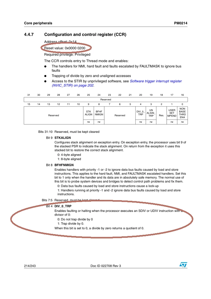

Thanks man. I found it. And thanks Gwenole, yeah divide by zero can also work but only if the divide by zero is activated in the CCR register, which I checked accidentally. and divide by zero is not activated.
But Tesla deLorean is rught NULL is a valid address in ARM. And i tried the value something like 0xcccccccc and I got the fault.
Vmere.1
Vmere.1Author
November 25, 2021
Thank you. Just one more question. is divide by zero should be activated or not? usual scenarios (I work in a project which is new ) and I noticed that DIV/zero is not activated.
waclawek.jan
November 25, 2021
0693W00000GYxlDQAT.pngJW
