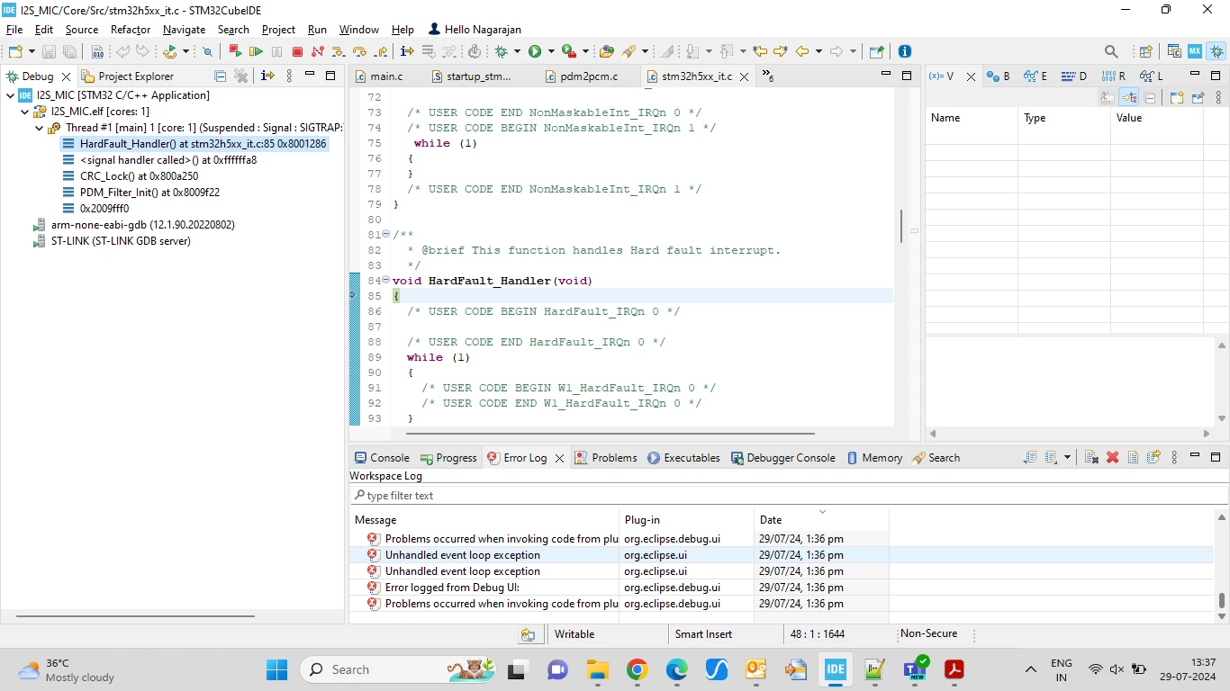

I am trying to convert microphone PDM signal into PCM signal and i used external PDM2PCM library files (which is used for STM32L4 cortex-M4) for that, i am able to bulid it for STM32H5 controller. When i execute the blelow PDM_filter_init function i am getting the hard fault error. Could you please help me to solve this issue.
void MX_PDM2PCM_Init(void)
/* USER CODE BEGIN 2 */
/* USER CODE END 2 */
PDM1_filter_handler.bit_order = PDM_FILTER_BIT_ORDER_MSB;
PDM1_filter_handler.endianness = PDM_FILTER_ENDIANNESS_BE;
PDM1_filter_handler.high_pass_tap = 2104533974;
PDM1_filter_handler.in_ptr_channels = 1;
PDM1_filter_handler.out_ptr_channels = 1;
PDM_Filter_Init(&PDM1_filter_handler); - Hard fault error occurred on this line
PDM1_filter_config.decimation_factor = PDM_FILTER_DEC_FACTOR_64;
PDM1_filter_config.output_samples_number = 125;
PDM1_filter_config.mic_gain = 0;
PDM_Filter_setConfig(&PDM1_filter_handler, &PDM1_filter_config);
/* USER CODE BEGIN 3 */
/* USER CODE END 3 */

Dear @Nagarajan ,
can you please have a screenshot on the Hardfault location and trace/log of the stack when at Hardfault while(1) . This is to check which instruction caused that .
hypothesis:
1) using a library not for Cortex-M33 / M4 should work also , but to check secure / non secure parts
2) Initialization is missing some hardware configuration
3) used library for PDM not ready for H5 series
Let us know ,

Would be helpful to see the disassembly or a proper dump of the failure..
If it's the call, then perhaps vpush on the function side, and the FPU not enabled?
Have your system output actionable information
https://github.com/cturvey/RandomNinjaChef/blob/main/KeilHardFault.c

July 29, 2024
I enabled the CRC feature as i was told it is a part of the procedure for PDM to PCM conversion. After executing the CRC_Lock() function it is going to hard fault error. I didn't enable the FPU.
