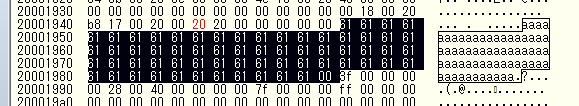

Hello!
I am trying to use USART2 + DMA for Rx/Tx. Tx is working OK already.
For Rx, I would like to use DMA circular mode.
I use followings.
  STM32L476 nucleo
  STM32CubeMX, STM32CubeL4 1.9.0.
After do workaround PLLM problem adding RCC_OscInitStruct.PLL.PLLM = 1;
I called,
HAL_StatusTypeDef HAL_UART_Receive_DMA(UART_HandleTypeDef *huart, uint8_t *pData, uint16_t Size);
     huart == &huart2
     pData == &receive_str[0] == 0x2000194c
     Size == sizeof(receive_str) == 64
until 63rd character receive there is no problem. I typed 'a' 63 times.
The black backed area is buffer for  Receive_DMA.

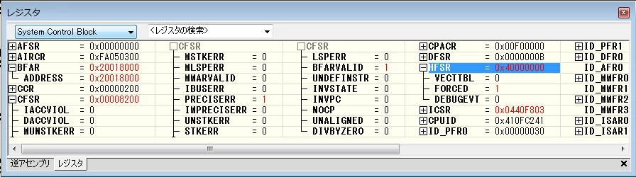

However, when I type 64th character 'b' Hard Fault raised as following.
'b' exists at  receive_str[63]  by DMA.
PRECISEERR is 1 , BFAR = 0x20018000.
It looks unwanted memory access to 0x200018000, did not such access.
DMAC is still transfers Rx data correctly.
I typed 'c' 3times, then the buffer is overwriten circulariy as expected.

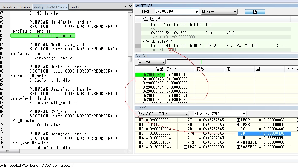

At the time, I lookd stack.
Does anyone know my mistake, or how to workaround?
Thanks!

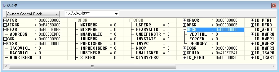

After I posted the above, I have investigated into this problem.
It might be caused by conflict between following two peripheral access.
    DMA1->CNDTR6 read by software.
    DMA1->CNDTR6 value reload by DMA circular transfer.
If I kill DMA1->CNDTR6 read code as a test, the hard fault will not be raised.
The problem looks also be timing critical,  but I have never seen the hard fault without CNDTR6 read for now.
Does anyone know a workaround or way for further investigation?
I read CNDTR6 to make FIFO for UART2 Rx, it is useful.
However, if there is no way, I will do other things.
Thank you.
