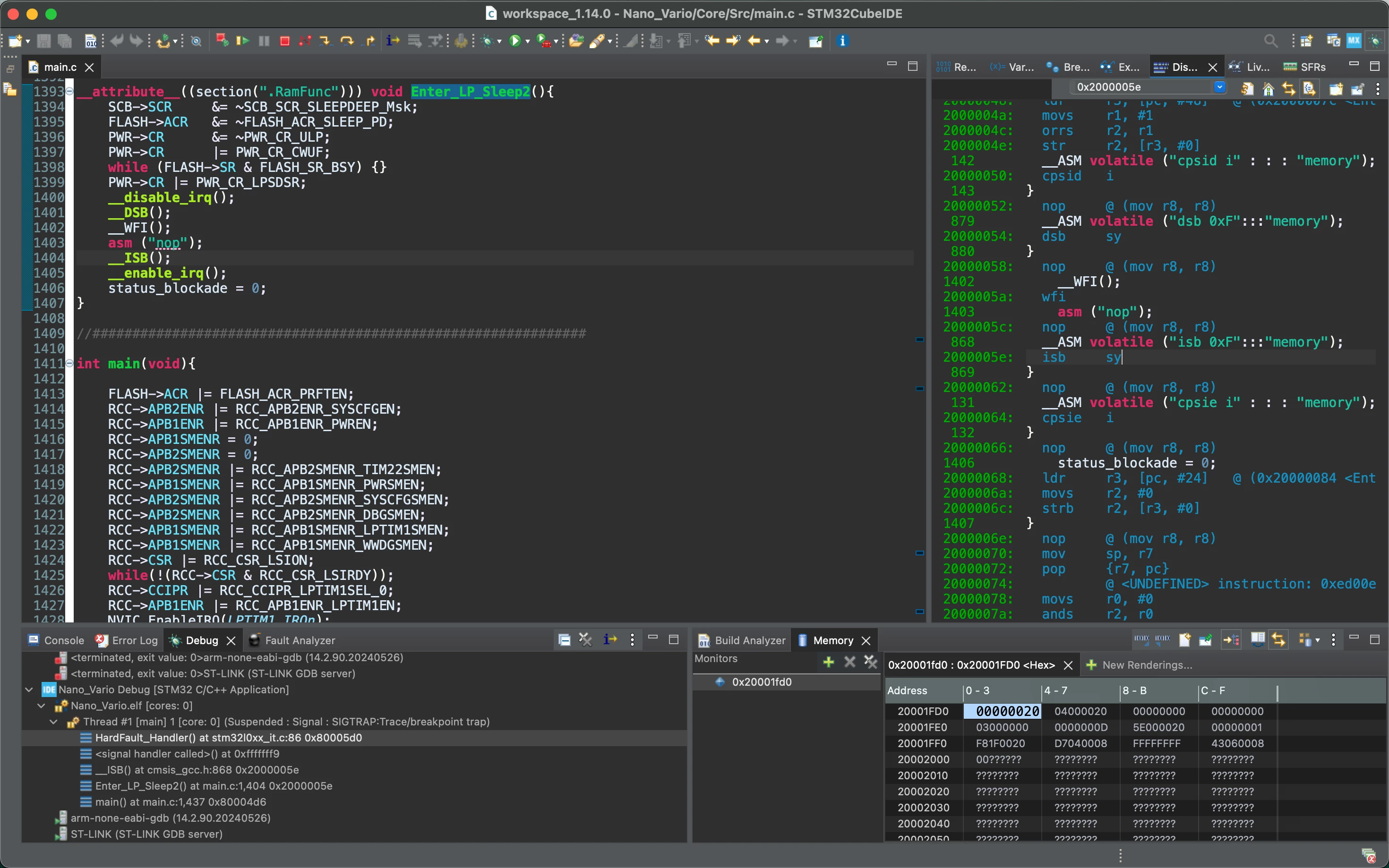

Aug 19, 2025 8:05 PM UTC
Because it's a Cortex M0 i don't have a lot of Hard Fault information (or do i?). I get the following from the debug window.Bildschirmfoto 2025-08-19 um 22.02.35.png

Aug 20, 2025 4:55 AM UTC
What says the Fault Analyzer tab next to the Debug tab?
BrigeiAuthor
Aug 21, 2025 8:18 PM UTC
i noticed, that the 2MHz for the MSI clock is to high for the low power sleep mode. Unfortunately it doesn't work neither. But i did find a work around which surprisingly works with the 2MHz as well. I just inserted another asm ("nop") after waking up (immediately after __wfi). And it definitely works - the mcu goes to sleep - i checked the current consumption.
