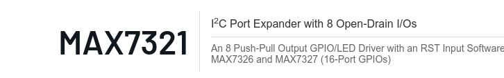

AScha.3
December 12, 2022
if needed speed is not very high, i would use a port expander, ie:
  • 3 of them make 24 lines with an active-low INT Output Alerts Change on Inputs
