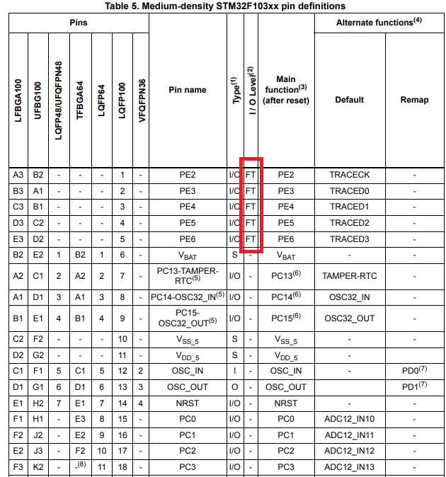

The five volt tolerent is managed by hardware on the IO structture itself. Nothing to do in the software:
The FT in this table in the datasheets tells what are the IOs five volt tolerent:
If an IO is FT means the alternate function available on the that IO supports the 5V input.

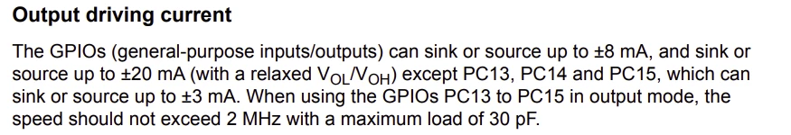

Also you need to take care about the sink current (five volt tolerent or not):
