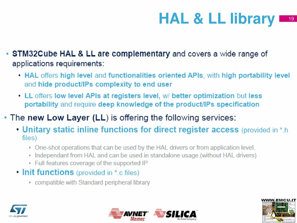

    The Low Layer (LL) drivers are designed to offer a fast light-weight expert-oriented layer which is closer to the hardware than the HAL. Contrary to the HAL, LL APIs are not provided for peripherals where optimized access is not a key feature, or those requiring heavy software configuration and/or complex upper-level stack (such USB).
    The HAL and LL drivers are complementary and cover a wide range of applications requirements:
    • The HAL offers high-level and feature-oriented APIs, with a high-portability level. They hide the MCU and peripheral complexity to end-user.
    • The LL offers low-level APIs at registers level, with better optimization but less portability. They require deep knowledge of the MCU and peripherals specifications

    Khalilfayache
    Visitor II
    November 22, 2021
