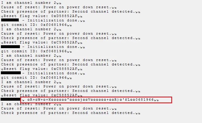

HAL_USART_Transmit_DMA sometimes sends rubbish to the serial interface
EDIT: Problem solved. The issue was caused by a missing / too short time delay between initialisation of USART and DMA and the first sent log message. After insertion of delay, everything worked like a charm!

I'm currently working on a STM32H755ZI, trying to get the DMA transfer to work for the USART1 serial interface (memory to peripheral). Basically, I managed to get it working. However, from time to time I'm having random-rubbish data on the serial interface after a power reset. If I'm stepping through the instructions with a debugger manually, everything seems to be fine, but after a power reset, sometimes the mentioned problem occurs. After a software reset, the data looks fine.

Still it does not work properly and fails at random. 4-5 times the data is transmitted successfully, and then some random data occurs...
What am I missing here?

Meanwhile I have tried a few other things, none of them was successful:
-Moved data buffers to different addresses, SRAM2, AXI SRAM
-"Manually" 32byte aligned the buffers in the memory (each buffer has its own section, defined in the linker file).
-Tried different MPU settings, disabled MPU
-Disabled other interrupts
-Tried different usart1 / dma settings
None of the above made a difference.. Now I'm out of ideas :(
I've attached a screenshot of the log, 3 times in a row everything is fine, and then after next reset, garbage data ist sent, but only for one of the messages, the other always seem to be fine...
What exactly is the hardware arrangement of the UART link, and how is it affected by the powerdown/powerup?
Observe the receiver using oscilloscope/LA, especially in vicinity of the STM32 powerup.
After initialization of USART in STM32, insert a delay worth several characters; alternatively, transmit several 0xFFs before anything else.

That was the problem !
I've had almost no delay between initialisation of USART / DMA and the first log message. I've inserted a short delay and suddenly the problem went away!
