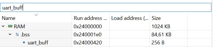

I am trying to receive an unknown length of data on a UART on a STM32H7A3
I have declared a buffer to receive the data and aligned it :
#define UART_RX_BUFF_SIZE 256
ALIGN_32BYTES (static uint8_t uart_buff[UART_RX_BUFF_SIZE]);

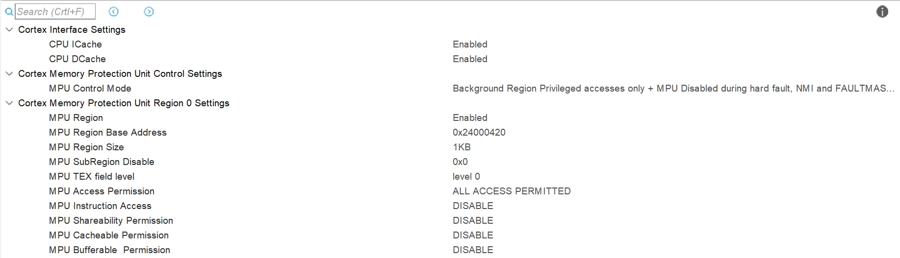

Then as I am working on a cortex M7 I have declared a "free" zone at the address of my buffer for the DMA to access it :
0693W00000HqnK2QAJ.png0693W00000HqnJxQAJ.pngThen I set up the handler to receive the character

My problem is that what the interrupt happens, I see that the size is correct (the number of bytes that I am expecting) but the RX buffer if filled only on the first character. So, I can only see the last received character and not the full data. Each byte overwrites the one that came before and I am left with only the last one. Is there a missing increment that I am supposed to change or do I miss something?

You have to manage D-cache:
https://community.st.com/s/question/0D53W00000oXSzySAG/different-cache-behavior-between-stm32h7-and-stm32f7
Alternatively you can use MPU to configure non-cacheable region. For quick testing purposes just do not enable D-cache.

@QLeco.1​ Also, the base address of a MPU region must be aligned on the region size.
You've defined a region with size 1KB at 0x24000420.
The cube should validate the MPU settings better...
