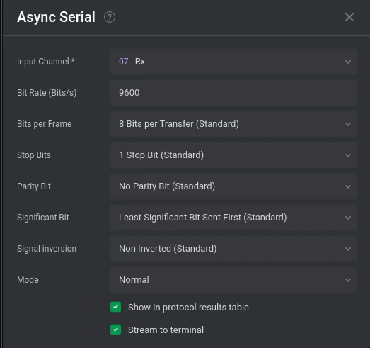

The GPS module has direct USB connection and I can see that 9600 baud with no parity and 1 stop bit is the correct configuration. My logic analyzer confirms this as well.

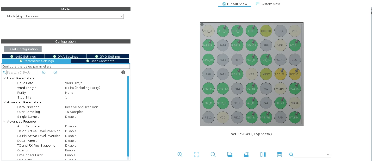

}CubeMX Setup for USUART1 (GPS UART)

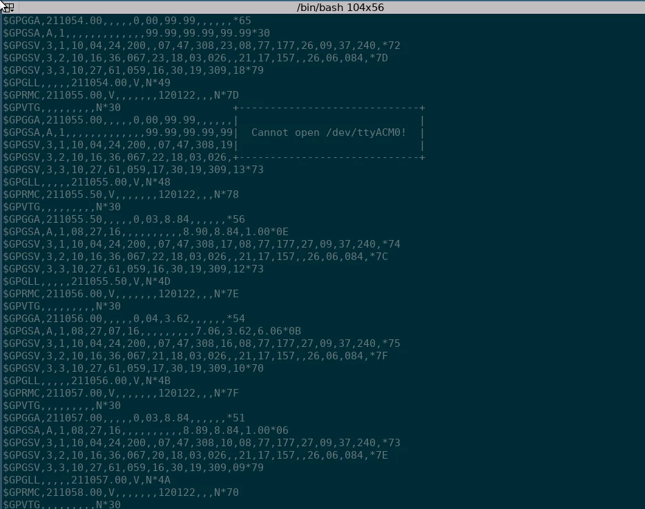

Serial Terminal Output when GPS connected directly to PC
Logic Analyzer Settings

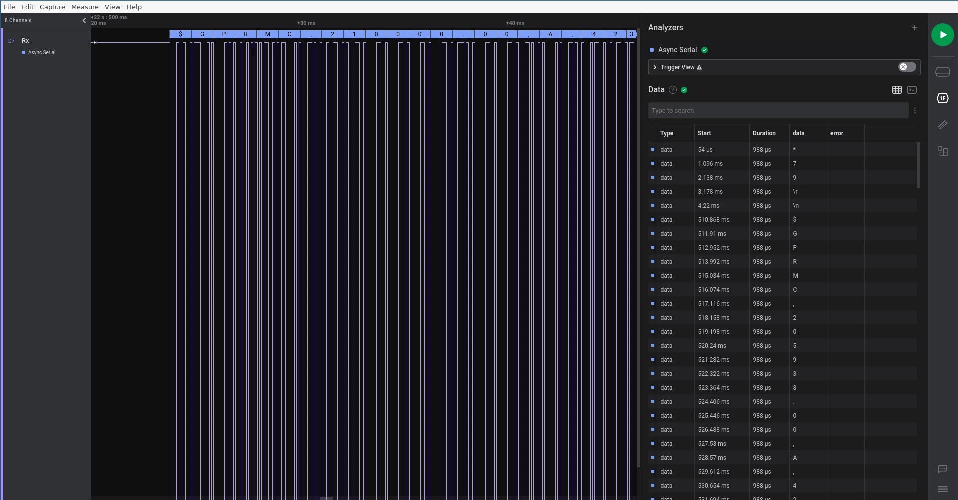

Logic Analyzer Capture (This is what the HAL should receive, or at least some snippet of it)
