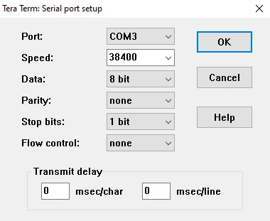

Hey,
I'm using STM32F303RET6 and need to implement UART communication via USART1 (PA9 as Tx and PA10 as Rx).
I managed to print "Hello World" on my console,Which means Tx is working fine and my console is configured correctly, but couldn't receive bytes from the console.
This is how I set up the USART using MXCube

 huart1.Init.BaudRate = 38400;
 huart1.Init.WordLength = UART_WORDLENGTH_8B;
 huart1.Init.StopBits = UART_STOPBITS_1;
 huart1.Init.Parity = UART_PARITY_NONE;
 huart1.Init.Mode = UART_MODE_TX_RX;
 huart1.Init.HwFlowCtl = UART_HWCONTROL_NONE;
 huart1.Init.OverSampling = UART_OVERSAMPLING_16;
 huart1.Init.OneBitSampling = UART_ONE_BIT_SAMPLE_DISABLE;

Also set your terminal to transmit continuously if this is possible so that there is no doubt the terminal has something been transmitted.
I do not know how your hardware setup is but One more things is to check that indeed you are using the PA10 as RX and the connection is okay.
Also try a smaller baud rate, like 9600 and see what happens
