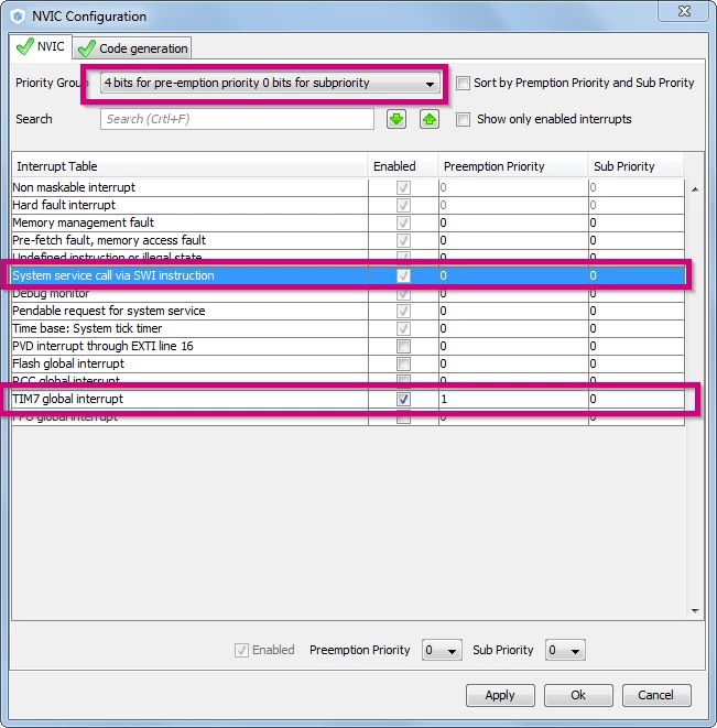

Using current HAL-software generated with cubemx on stmf4_discovery board.
I use TIM7 as an interrupt generating timer, set at say 100 msec.
In the ISR I do:
    i = HAL_GetTick();
    delayms(12);
    tt  = HAL_GetTick()-i;
where delayms is a busy waiting loop (normally our application code would go there).
And tt is a global int.
I would assume that tt would normally be something like 11, 12 or 13.
But it is always 0.
The (default) interrupt priority of TIM7 is much lower (higher number) than Systick, so why isn't the system tick not updated in that 12 msec?

    Radek RIPA
    Radek RIPABest answer
    Dec 8, 2016 2:35 PM UTC
    Posted on December 08, 2016 at 14:35
    The priority -1 on systick is taken in care only when the two interrupts have same settable priority.
    By default in CubeMX the Systick is set to 0.
    If you are using the CubeMX project please check the systick an tim7 priority in the project and the group priority option.
    If the group priority do not have any bits for preemption priority then the interrupt cannot preempt second active interrupt.
    If you are not using the CubeMX please check the HAL_NVIC_SetPriorityGrouping and HAL_NVIC_SetPriority functions if they using correct priorities for systick and tim7 and correct group priority.
    Best regards
    Radek

    Sietse
    SietseAuthor
    Dec 8, 2016 12:33 PM UTC
    Posted on December 08, 2016 at 13:33
    I think I did follow the first scenario of Walid, and I just checked whether the Systick ISR is called when in the TIM ISR.
    It is NOT called at all.
    I did not change any priority, so the priority of Systick (-1) is much higher than that of TIM7 (55), so the systick should interrupt the TIM7 isr!
    So I still don't understand it.

    Sietse
    SietseAuthor
    Dec 8, 2016 3:21 PM UTC
    Posted on December 08, 2016 at 15:21
    Thanks! Thats it.
    I wrongly mistook the index in the interrupttable as the priority:(
    It's working like a charm now. Thanks again.
