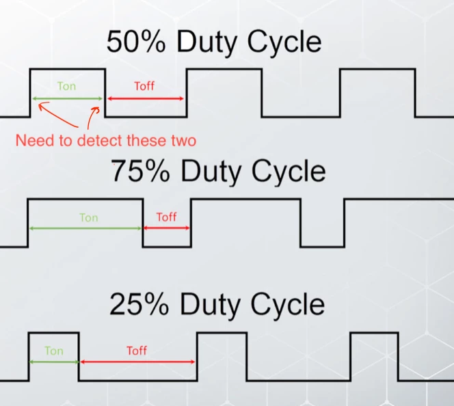

> add a callback to get the state of the pulse
What do you mean exactly by "callback to get the state of the pulse"? Draw a diagram.

I need to generate pulses with a given duty cycle and need to detect when the pulse is rising and falling before and after the duty cycle.
The idea is that the PWM was controlling the strobe of a lamp by turning on and off the output. But that's not possible anymore and the lamp must be have voltage continuously and the strobe must be controlled my changing the brightness of the lamp instead. What I did is to disable the output at the PIN number 6 for channel 1. But I would like to get the rise and fall events at the beginning and the end of the duty cycle so that I can change the brightness of the lamp between 0 and 99 to perform the strobe.

The Update interrupt is triggered by one edge of the pulse, and the CCx interrupt is triggered by the other. So enable the CC1 interrupt by setting TIMx_DIER.CCxIE.
