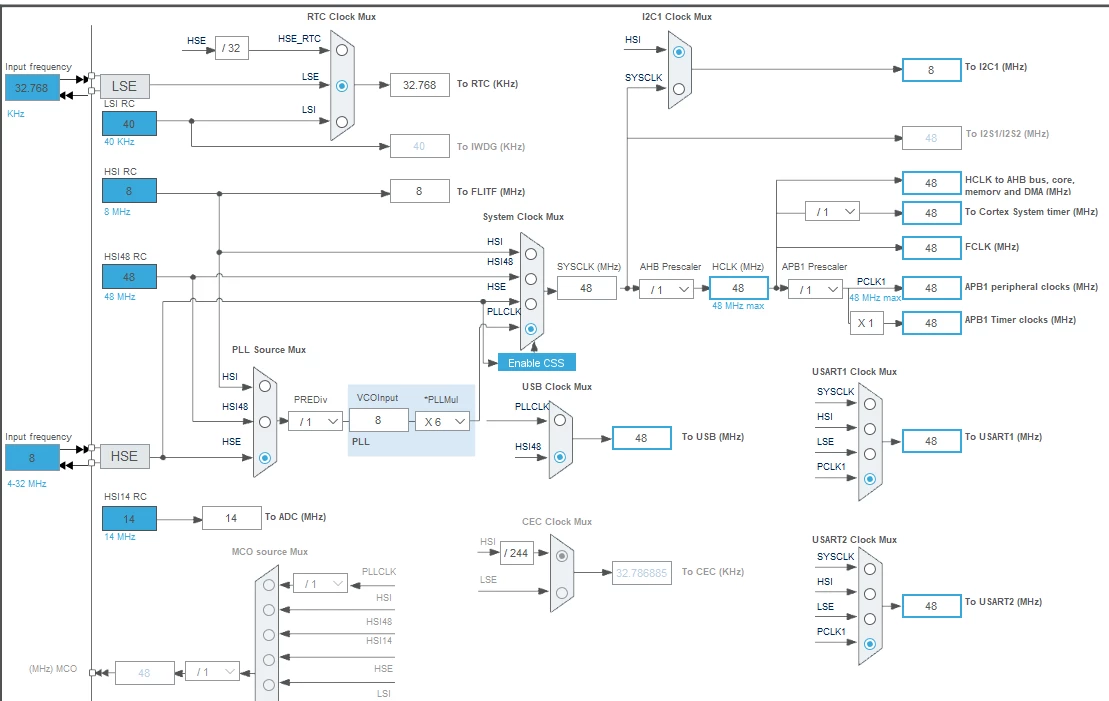

I having an issue with HAL SysTick interrupt on STM32F072B mcu:
With default configuration (see the image) and an external 8MHz oscillator,
if i toggle a pin in the SysTick interrupt, i get a state change every 0.75 ms instead of 1 ms...
What is wrong? I have to set a calibration register or similar?
Thank you all for support 8)
Matteo
Check the schematics of your board, I suppose the default 8 MHz quartz frequency is not correct.
waclawek.jan
Jan 14, 2020 9:47 AM UTC
Read out and check the systick registers.
If possible, output SYSCLK to MCO and check.
Alternatively, try to use HSE as SYSCLK directly, without using PLL. How does the systick clock change?
Is HSEBYP set in RCC.CR?

Thank you all... but I found the mistake !
I was using a broken oscilloscope, with wrong time base calibration !!!!!
:persevering_face: :pouting_face: :face_screaming_in_fear:
Regards!
