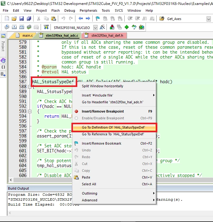

    Zt Liu
    Senior III
    Jun 5, 2017 2:10 PM UTC
    Posted on June 05, 2017 at 16:10
    if you are using ide like Keil MDK,
    you can right click on some type or struct XXX that you're interested,
    and click Go to definition of 'xxx',
    then you will jump to the definition.
    you can find similar function in your ide.
    Good Luck!
