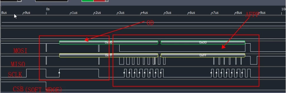

The slave device on my side is a fake PP output. It needs a pull-up resistor. I know this is not in accordance with the SPI agreement, but there is no way. When I run the HAL_SPI_Transmit() function, an incorrect pull-up signal will appear in the first cycle of initialization. If I remove the pull-up resistor, the wrong pull-up signal will disappear. So I think HAL_SPI function has wrong OD output in the first cycle of initialization.

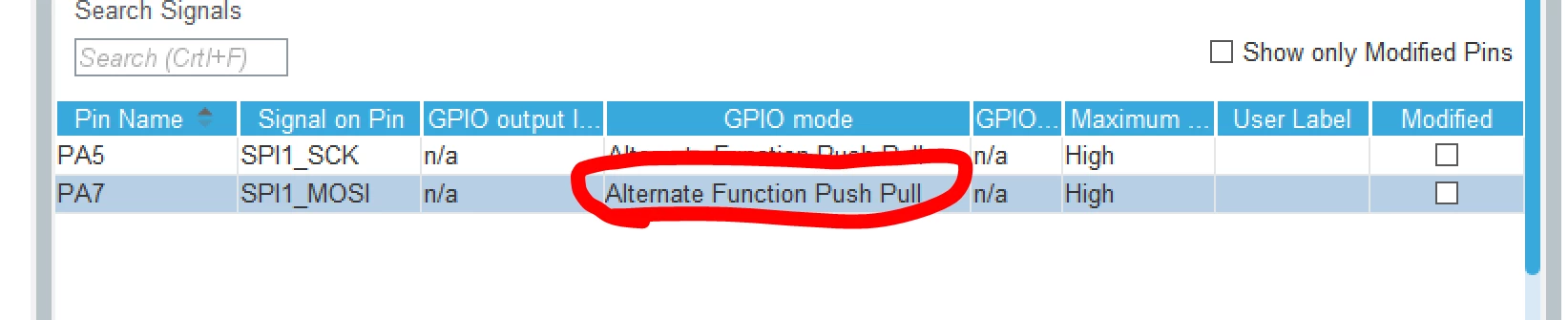

There is no need to guess. The pin mode is shown in CubeMX and can be verified by looking at registers.
Before the peripheral is active, the line is not driven on the STM32 side. If you need it to be high or low, you will need an external resistor.
Typically a CS line with an external pullup is used so the master and slave can sync and the slave can ignore clock pulses before the peripheral is ready.

I know pin mode in Hal_ SPI_ MspInit()。
// code
GPIO_InitStruct.Pin = SPI1_SCK_Pin|SPI1_MOSI_Pin;
  GPIO_InitStruct.Speed = GPIO_SPEED_FREQ_HIGH;
  HAL_GPIO_Init(GPIOA, &GPIO_InitStruct);
  GPIO_InitStruct.Pin = SPI1_MISO_Pin;
  GPIO_InitStruct.Mode = GPIO_MODE_INPUT;
  HAL_GPIO_Init(SPI1_MISO_GPIO_Port, &GPIO_InitStruct);
Except for the first cycle, this program can work normally.

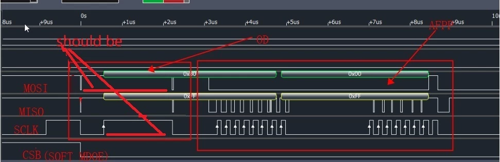

My question is why there is an OD signal before sending data in the first cycle of initialization.
As shown in the figure, there should be no signal driven by the pull-up resistor.

3,Occurs only after HAL_SPI_Transmit () or HAL_SPI_TransmitReceive() function is called. It only occurs before the data occurs. After the data is sent, the OD phenomenon will not occur again.Since this happens inside the HAL_SPI_Transmit () function, my CSB signal cannot remove it from it.

My slave device is a fake PP output. So it must have a pull-up resistor,include SCLK MOSI MISO CSB.
0693W00000Hpv1LQAR.jpgThe second transmission has no wrong clock signal.Never again.
