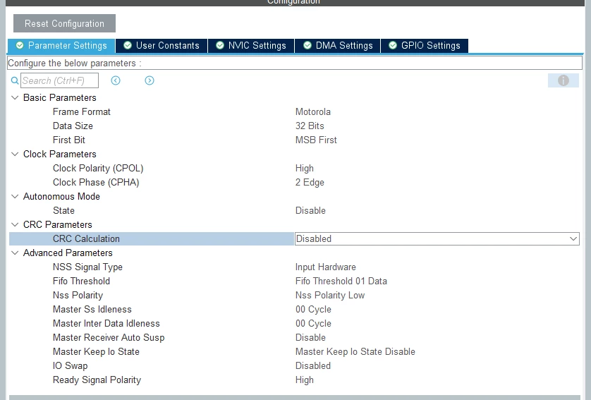

I am having problems trying to use the HAL_SPI_TransmitReceive function.
I am using STM32CubeIDE along with the STM32U5G9J-DK2, I am configuring my side as a full duplex slave using the following parameters:
I am working with an embedded processor that is acting as the Master, the features of which I do not have a complete understanding of. I do know it's implemented as a full duplex Master with the SPI1 port enabled. We have the embedded processor connected to the STM chip using the following pins.

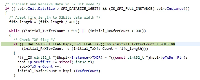

In order to simplify things, I have reverted to using HAL_SPI_TransmitReceive instead of the DMA version so I can step through some of the code in stm32u5xx_hal_spi.c and get an idea of what's going on. I get the same strange issues with a corrupted receive stream when using this function if I set my transmit buffer to all 0xFFFFFFF. I have found that when calling HAL_SPI_TransmitReceive, the software gets stuck in this loop...
...because the TXP flag is set to 0 indicating that there's not enough free space in the TxFIFO. Also, the SPI_SR_UDR is set indicating there was an underrun in the transmit. Again, if I set my transmit stream back to all zeros, I do not hang in this loop and my receive data is not corrupted. (Also, nothing was hanging when I was using the DMA version of the function).
