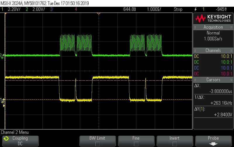

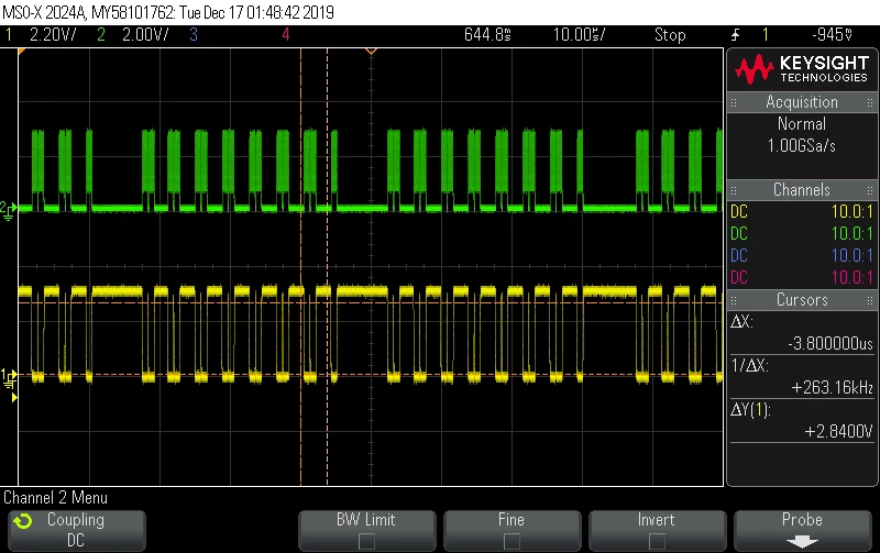

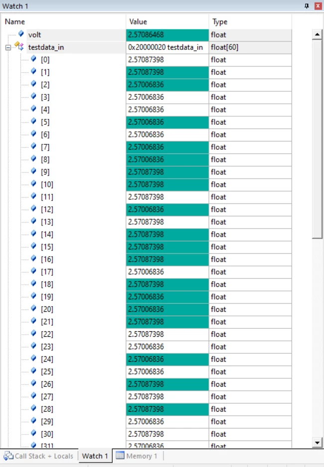

    I use same code for the external ADC cmmunication with SPI interface. I get the correct digitized values. But the CS signal looks a little strange. For example during the reset state, there is a dirac signal. Does anyone have an idea to fix the problem? Also, How can I control CS sampling rate more precisely? Because I want to get 1MSPS rate.
    In CubeMX,
    SPI4 set as Full-duplex Master
    SPI4 NSS as Hardware output
    RCC as High Crystal Clock
    In clock settings, 8MHz, HSE, PLLCLK, and SYSCLK as 160MHz.
    In SPI4 configuration, Motorola, 16 bits, MSB, 4, 20Mbits/s, Low, 1 edge, sequentially.
    DMA is not enabled.
    SPI4 global interrupt enabled.
    In Keil IDE,
    Variables:
    uint8_t i; // The index number of the testdata_in array
    uint16_t Sample;
    float volt=0; // Decimal value of the conversion
    uint8_t ADC_Buf[2]; // Output of ADC
    float testdata_in[60]; // 16 different ADC values in this array
    Main code calls in main.c file,
     while (1)
     /* USER CODE END WHILE */
     /* USER CODE BEGIN 3 */
         HAL_SPI_Receive_IT(&hspi4,ADC_Buf, 2);
            while(HAL_SPI_GetState(&hspi4) != HAL_SPI_STATE_READY);
            Sample = (((uint16_t) ADC_Buf[1]) << 8 | ADC_Buf[0]) & 0x0FFF;
            volt = (float)(Sample * (3.3 / 4096.0)); //
            testdata_in[i++]=volt;
            i %= 60;
    void HAL_SPI_TxRxCpltCallback(SPI_HandleTypeDef *hspi)
       printf("End InterrupTXRX\r\n");
