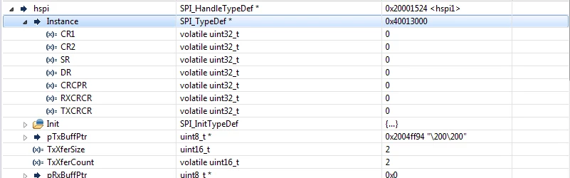

I used to have the SPI1 working connected to MAX31865 breakout board. For some reason it's not working at all now. I traced into the code, seems HAL_SPI_Transmit() failed on
__HAL_SPI_GET_FLAG(hspi, SPI_FLAG_TXE) until timeout.
Seems the TXE flag never get set. Not sure what's going on.
And all of the SPI1 instance registers (CR1, CR2, SR, DR...) have value 0. See below screen shot.
I am kind of don't believe all the registers value be 0 first. Secondly it used to be functional not long ago.
Is there anything I am missing here?
Thx
