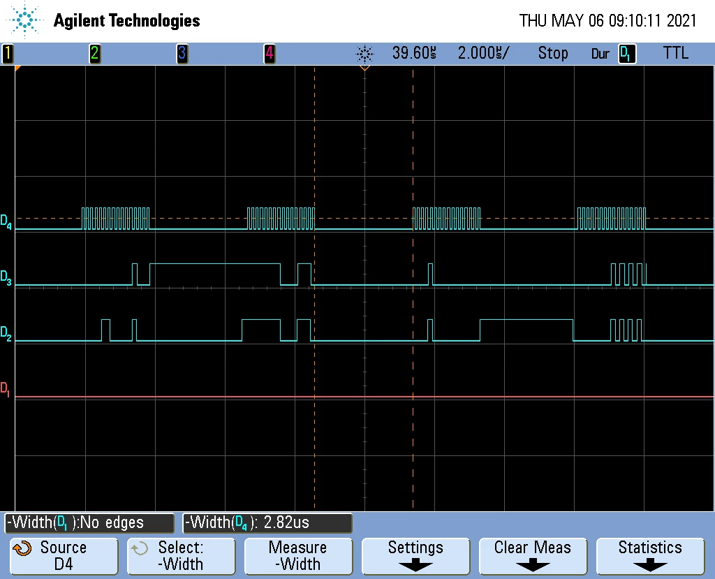

I've found some strange issues during my reception of data at SPI interface using HAL functions.
The problem is that between each two complete cycles (8 periods) of SCK signal, the SCK line stays idle without reading any data. With longer streams of data, the acumm delay is bigger so it's a problem. In my application, the SPI TX/RX is critical and execution task time must be as short as possible.
if (hspi1.State == HAL_SPI_STATE_READY) {
 HAL_SPI_Transmit(SPI1_DataLink.SPI_Handler, (uint8_t*)localB->buff, localB->DataTypeConversion1,
 		 SPI1_DataLink.timeOut);
 HAL_SPI_Receive(SPI1_DataLink.SPI_Handler, (uint8_t*)G_SPI1_DataBufferRx, SPI1_DataLink.nb2Rcv, SPI1_DataLink.timeOut);
 0693W00000ANX8iQAH.pngD4-->SCK D3-->MISO D2-->MOSI D1-->Chip Select
As you can see inter 2-byte space is 2.82us while SCK clock is 120ns period, Im wasting too much time.

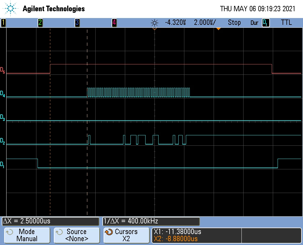

There is another stranger issue... when I just transmit with HAL_SPI_Transmit() function these delays completely dissapear.
0693W00000ANX8nQAH.pngD5-->GPIO measuring HAL function execution time
In a future post I will ask about why Im losing 2.5us between start of HAL_SPI_Transmit() execution and first SCK cycle or 5.54us between last SCK and end of mentioned function execution...

waclawek.jan
May 6, 2021
Which STM32?
Cube/HAL is not written for best timing. Easier coding means sloppy result. Choose your preferences.
Try switching on compiler optimization.
RGalvez
RGalvezAuthor
May 6, 2021
I'm working with the F303.
Yes, I'm going down into register level but as it is a known issue (from a couple years ago), maybe someone has found the solution remaining at HAL level
After compiling my receiving function with __attribute__((optimize("-Ofast"))) inter-SCK space lows from 2.82us to 2.70us.

S.Ma
Principal
November 1, 2022
SPI is high bit rate and deserves DMA block transfer. SPI should be using Transmit receive function, so 2 DMA channels : RX and TX to 2 buffer of same size. If master, DMA TX set the number of SCK clocks while transaction ends by receive dma block interrupt.
