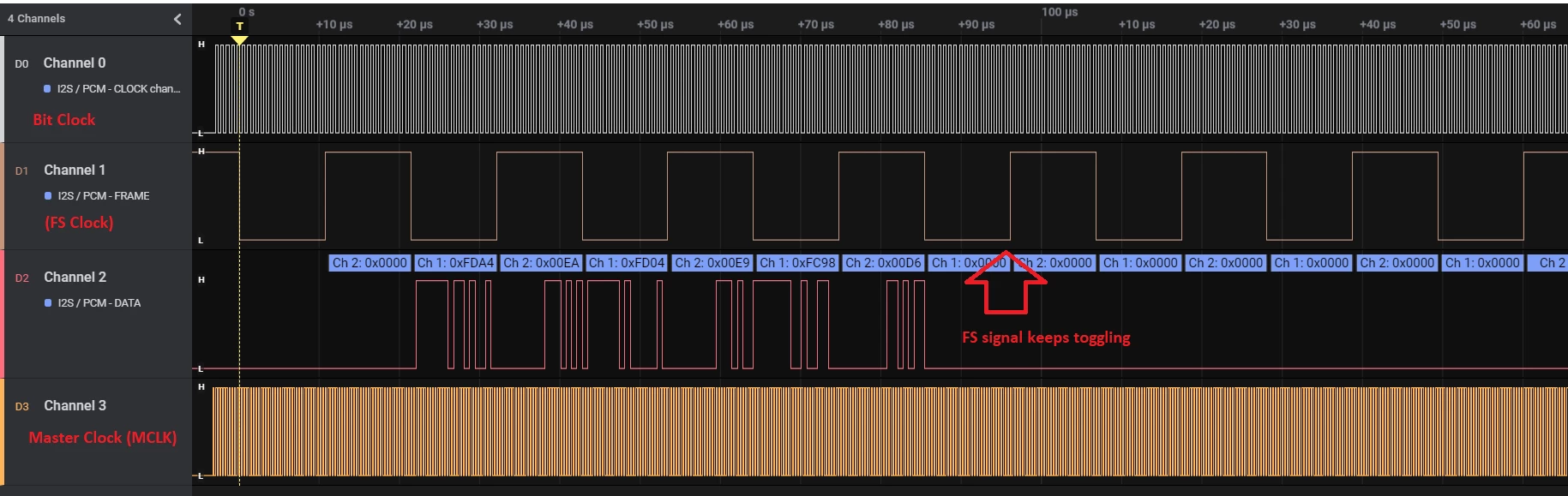

My concerns is with the statement "However FS signal generation is
conditioned by the presence of data in the FIFO". Looking at a logic analyzer, I see the FS signal (or WCLK) always toggling even after the FIFO is flushed onto the I2S bus. See screenshot below:
Question 2: Is this a bug in the STM MCU / driver, or is the reference manual incorrect?

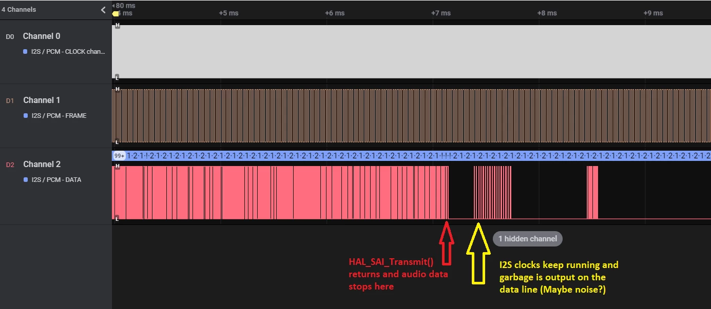

I am attempting to transmit a small portion of an audio file as a test. The audio file is 44.1 KHz, stereo (2 channels), 16-bits per channel. Since the clocks keep running after HAL_SAI_Transmit() returns, garbage is sent to the DAC on the data line beyond the end of the specified buffer length as seen below:
Question 3: If the clocks do keep running after HAL_SAI_Transmit() returns, why am I seeing garbage output on the data line instead of 0x00 as defined in the reference manual? Is the only explanation that it could be coupling to the other clock lines and picking up noise?

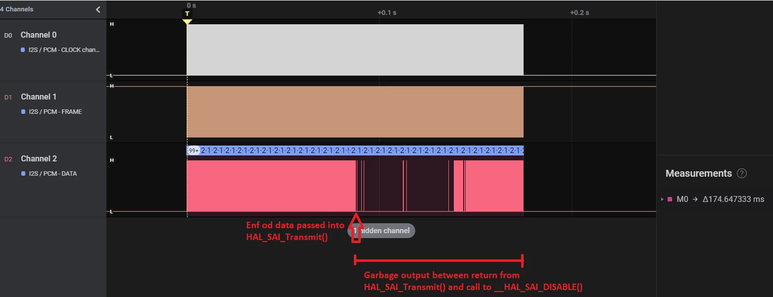

Edit: I tried calling __HAL_SAI_DISABLE() after HAL_SAI_Transmit() returns and some garbage data is still output before the SAI clocks actually stop as seen below:
Interestingly the garbage data looks the same across multiple captures so this makes me think the SAI driver / hardware is incrementing beyond the end of the transmit buffer and outputting random data from RAM. I have verified the 'Size' value passed into HAL_SAI_Transmit() is the length of my buffer so I don't see why data beyond this would be output.

Edit 2: Putting this at the top to save others time of reading this whole post. After investigating a bit more, this turned out to be a lack of documentation. The SDK examples pass a buffer of type uint16_t into HAL_SAI_Transmit_DMA() which accounts for the 16-bit data size. For example:
uint16_t PlayBuff[PLAY_BUFF_SIZE];
HAL_SAI_Transmit_DMA(&SaiHandle, (uint8_t *)PlayBuff, PLAY_BUFF_SIZE);
In the above example, PLAY_BUFF_SIZE is the number is 16-bit data elements which matches the configuration of SAI_DATASIZE_16, not the number of bytes. I made the assumption that the "Size" parameter in HAL_SAI_Transmit() was in units of bytes like most of the other STM32 HAL functions. I think the HAL documentation and function header should be changed from "Size Amount of data to be sent" to "Size Amount of data to be sent in units of hsai->Init.DataSize" or similar.
This particular issue has been resolved.

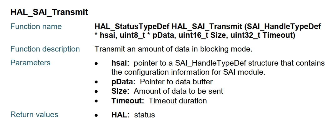

Hello @Community member​ ,
According to the HAL API document:
Based on this description, HAL_SAI_Transmit() will "Transmit an amount of data in blocking mode" where Size: Amount of data to be sent.
Looking at the logic analyzer, more than "Size" bytes are output on the bus. According to the STM32L4R9 reference manual: "If there is no data to transmit in the FIFO, 0 values are then sent in the audio frame with an underrun flag generation."
So I would expect the data line to be held low after HAL_SAI_Transmit() transmits all bytes. Instead, garbage (random data) is being output. I guess I will start debugging the HAL SAI driver...
