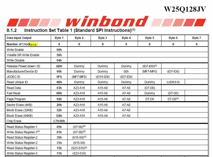

I'm using STM32H750B with a NOR flash (Winbond's W25128 chip). When the chip is configured as QPI mode. If polling SR1 using the auto polling function, it will throw error. But read SR directly and check the bits works.
Any help? Thanks.

Feb 4, 2021 11:00 AM UTC
Hi @diverger​ ,
I see you are trying to use QUAD 4-4-4 mode, memories that support this mode require to enable it.
Are you sure that the memory support the Quad mode ? If yes, did you correctly enable it ? Please share the exact memory part number.

Feb 8, 2021 9:20 AM UTC
Hi @diverger​ ,
I found different info that you may want to check: according to the W25Q128JV datasheet, the read status register is only in standard SPI mode (1-1-1).
For more details, please check the W25Q128JV datahseet , in sections:
  • 8.1.2 Instruction Set Table 1 (Standard SPI Instructions)
  • 8.1.3 Instruction Set Table 2 (Dual/Quad SPI Instructions)
  • 8.2.4 Read Status Register-1 (05h), Status Register-2 (35h) & Status Register-3 (15h)
Imen

Feb 10, 2021 1:44 PM UTC
Hi @Imen DAHMEN​ Thanks for your patience.
Actually I'm not very sure if my chip is W25Q128JV or W25Q128JV-DTR (the chip is on a EVAL-board, and I need ask for the BOM to get the exact part number), the latter one apparently supports this command in QPI mode. And I can read the JESD SFDP table, it shows it support DTR, so my chip is very likely the latter one. And another evidence is, I can read back the status register in QPI mode (using 4-4-4 line pattern) indeed. As you know, auto-polling is just making the read-and-check more 'auto', they use same command.
Thanks.
Imen.DBest answer
Feb 10, 2021 3:25 PM UTC
I confirm that W25Q128JV-DTR supports QPI mode.
Can you try your indirect mode configuration (4-4-4) and add 1 or 2 Dummy-cycles ? for example: qspi_cmd->DummyCycles = 2;
Then, please keep me informed about your progress on this.
Imen
